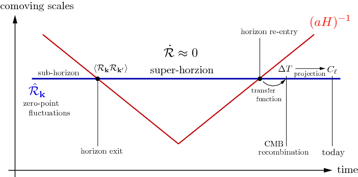

In summary, fluctuations exist on all scales at the end of inflation, marked by the bottom of the red "V" in the figure (the quantity 1/aH is a minimum at the end of inflation). However, what we see in the CMB are these fluctuations at recombination, after several scales have had the chance of re-entering the horizon. Once re-entry occurs, they begin to oscillate as sound waves: the fundamental tone has had time to compress just once by the time of recombination. This agrees with your understanding of the relation between the Jeans mass and the fundamental mode of the acoustic waves.

After much reading I still don't understand your answer that there are already perturbations right after end of inflation. From this kind of figures they reappear late in the baryon-photon period. Do I make wrong conclusions from this and other figures?
A
There are fluctuations existing on all scales at the end of inflation, marked by the bottom of the red "V" in the figure (the quantity 1/aH is a minimum at the end of inflation). However, what we see in the CMB are these fluctuations at recombination, after several scales have had the chance of re-entering the horizon. Upon re-entry, they begin to oscillate as sound waves: the fundamental tone has had time to compress just once by the time of recombination. Does this agree with your understanding?
Not totally. Why is the late re-entry always specified. Does this mean that all we see on the last scattering surface derives from the period between that re-entry and the sound-horizon.
What I also not understand is the correlation right after the end of inflation between the Hubble sphere which had during inflation a real (event)horizon and the then created particle horizon. According to me both are very different but on the figures they go on as a single line after inflation.

We see everything from the present horizon all the way down to smaller scales well-within the sound-horizon at decoupling. However, only those modes with wavelengths on order of and smaller than the horizon at decoupling are oscillating (see Figure 4 in the article I referenced earlier).
Can you reference a particular figure where you see this? Often in the literature, the Hubble sphere is taken to correspond to the event horizon, even though this identification is only true in de Sitter space.

I agree with Wayne and I don't believe I've contradicted him: one has fluctuations immediately after inflation, but only those within the horizon have had time to complete oscillations as sound waves. There are of course some modes within the horizon at the end of inflation, but those that are much larger are effectively frozen -- this is a simple causality argument. The horizon is not a hard boundary, beyond which all modes are completely frozen; indeed, the fundamental mode has a wavelength twice the horizon size and it has completed a half oscillation. The horizon can, however, be used as a quick way of separating the effectively frozen modes from the acoustic waves, and the temperature spectrum illustrates this fact (broad central peak corresponds to fundamental mode, with the correlation dying off at larger scales).
