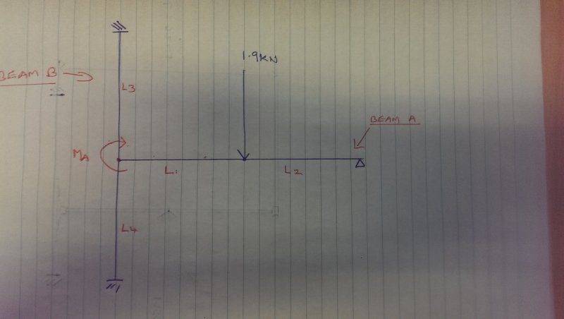

Hello all,
I'm struggling with a beam problem and hoping someone can help. I have a beam with a point load in the centre (Beam A), one end of the beam is treated as simply supported and the other is attached to a metal plate (Beam B) which is fixed at both end (welded). I am trying to find the max deflection and max stresses in each beam but am unsure of how to approach such a problem. Any guidance would be greatly appreciated. I have looked in Rourke and searched the internet but can't find a relevant example or formula. I presume it will require a combination of beam formulas but do not know where to start!
I am thinking the the load on Beam A will create a moment in Beam B (Ma). Then this moment could be could be split into two forces, one positive and one negative, then use fixed beam formulas and method of superposition to combine the 2 deflections due to the 2 resulting forces on Beam B?
  • #65
np86:
Please don't hijack other member's HW threads.
If you have a HW problem to post, please follow the Rules and post it using the HW Template.
What you have here is a frame of some sort and must be analyzed as such. There is no simple formula for it, nor do I expect will you find one in a handbook like Roark's. Most engineers will use software to model such a frame to find the deflections, if it were a simple frame. According to your description, beam B is a plate of some sort, which usually cannot be modeled as a simple beam. More information, including a better sketch of the components of this structure, would be required to analyze it.
