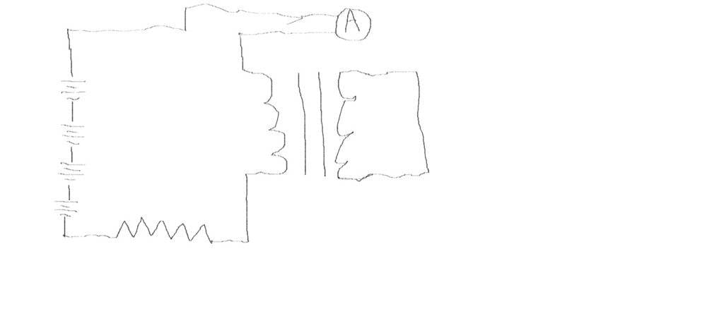

i tried connecting flyback converter to, i think it was 3 18650 lithium ion cells, and using a, i think it was a 3.5 ohm resistor. i got a reading of 3.5 amps
then i got a decreasing reading. then one of the 18650 lithium ion cells overloaded. it is now damaged. is there any way to pass 3.5 amps through flyback converter, without overloading the 18650 lithium ion cells? this a schematic of the circuit i used.

Not certain, but I think you might be missing some parts, here is a basic flyback schematic:
Likes davenn
i forgot to include the diode in the schematic. sorry. i didn't include a capacitor. if i use nonrechargeable batteries, can i pass 3.5 amps through the flyback converter without overloading the batteries?
You also don't have a switch, which is basically the most critical part, or a means of creating PWM. Based on your schematic you are connecting a transformer to a DC supply through a resistor. Transformers only work with AC.
Your question of "can i pass 3.5 amps through the flyback converter without overloading the batteries " depends entirely on the batteries.

The way I would approach that question is to look up the data sheet for the proposed battery, determine its maximum discharge rate and total capacity (Whr or Ahr) and use that information to calculate how long the batteries would last with my load. Then you can decide if they are appropriate.

It helps to look up the real number rather than just ask questions. I searched "18650 specifications" and quickly found the following.

And yes, you can connect them in parallel to provide twice as much current. But there are caveats. The batteries in parallel much be closely matched.
so if i connect them in parallel i can get twice as much current, without overloading the batteries?
According to the Data Sheet posted by @anorlunda and your statement of measuring 3.5A, you did NOT overload the batteries, the batteries are rated at 20A.

I think, if necessary, there are theoretically two ways to get more than rated current of single battery from multiple batteries.
1. Batteries in parallel plus prevention measure for circulating current flow between them, as well as other protections, such as each battery has its own over-current protection...
2. Batteries in series plus stepping down converter to generate more current...
Since you already have a flyback converter installed in your circuit, you may consider the second method and include the function in the flyback converter.
I don't like using batteries in parallel because I personally think that this is not a good approach, especially for DIY projects.
Besides, please pay attention to battery and circuit safety issues. You may reference the relevant instructions, standards and regulations for more information.

I am discussing the feasibility of one of these options. In theory, a DC-DC flyback converter with regulated output voltage can boost or step down a variety of input voltages
If there is no specific reason to fix the input voltage, as long as the input voltage of the flyback converter is still within the rated range, it should be possible to connect more batteries in series to the input and then reduce the input current. Note that I = P / V. For the same power, a higher voltage indicates a lower current.
So I'm talking about integrating the input current reduction function into the existing flyback converter, not necessary to change it to step-down converter, nor adding another step-down converter.

Forget about high current, get a working circuit sorted out first
You haven't even listened to what you were told in post # 4
