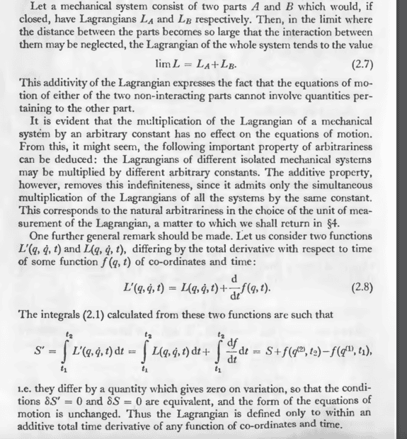

Trying to grasp the Landau's book and struggling here. (Attaching the image).If you multiply L by some constant and put it in in the Euler-Lagrange equation, motion equation won't be changed.
Q1: Though, what does he base his logic to say ##Lim L = L_A + L_B##. If we got 2 separated system, he says total lagrangian of the whole thing is the sum of each part's lagrangian. What's the proof of this and how does he know it ? At that point, he doesn't even know what form Lagrangian has.
Q2: He proceeds to mention: "the Lagrangians of different isolated mechanical systems may be multiplied by different arbitrary constants. The additive property, however, removes this indefiniteness, since it admits only the simultaneous multiplication of the Lagrangians of all the systems by the same constant. " which is also unclear.

Take it as two different Lagrangian systems which are considered simultaneously. These systems are described by different sets of different generalized coordinates. In the theory of dynamical systems, this is called the cross product of the dynamical systems.
$$L_A=L_A(t,q,\dot q),\quad L_B=L_B(t,x,\dot x).$$ The variables ##x,q## are separated in the differential equations with the Lagrangian ##L=L_A+L_B##

1. why does he use Lim ?
2. When wouldn't we have ##L = L_A + L_B## all the time ? it simply means adding 2 things give the sum of these together which should always hold true. It's interesting that I asked a question why it would hold true at all and now I'm asking why wouldn't it hold true all the time ?
He said that he moves away the systems from each other to the infinite distance

When wouldn't we have L=LA+LB all the time ?
we have it all the time
UPD: consider for example two pendulums that do not interact
Likes vanhees71

1. So he just uses Lim to say that even for the infinite distance, it would hold true. He basically states mathematically that it would hold true for any distance. right ?
2. Isn't it pointless to say this at all ? how can summing 2 things ever give something which is different from the sum ? it's like 2+2 != 4
the lim means "system ##L_A## does not interact with system ##L_B##"

Well, I get that but even if they are interacting, would not Lim L = L_A+L_B hold true ? If not why ?

2. I get you point about pendulum, but remember, that at the point where landau explains all it, it doesn't know that L is a function of kinetic and potential energies in which case in connected pendulum by a spring, why would you assume total lagrangian wouldn't be the sum of each part ? For the total lagrangian, you say spring also gets included, but does it get included as potential energy or just separate Lagrangian(equation of motion of the spring) ? if separate lagrangian, it might be clearer now. Thoughts. ?

Do you also agree that Landau is unneccesarily complicated
He is not complicated, he is messy.
I remember that. I just try to give an acceptable explanation.
It depends on the statement of the problem. If the spring is massless, then the Lagrangian is written in one way, if not then in another way.
