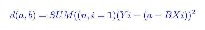

note a linear regression model with the response variable Y=(Y1..Yn) on a predictor variable X=(X1..Xn). the least squares estimates of the intercept and slope a(hat) and B(hat) are the values that minimize the function: (see attached image)
and the problem reads on further -
further predicted values equal y(hat)(x)=a(hat)+b(hat)x (note y(hat) is meant to be read as a function of x)
i have been asked to find y(hat)(Xbar), where X(bar) is the average of the Xi's. (note y(hat) is meant to be read as a function of Xbar).
i'm not sure where to start with this question. advice as to whether I'm on the right track is all i need for now.
so i was thinking that i could use the fact that
a(hat) = Y(bar)-B(hat)X(bar) and B(hat) = (sum) (Xi-X(bar))(Yi-Y(bar)) /(sum) (Xi-X(bar))^2
but I'm not exactly sure how to solve for y(hat)X(bar) -(yhat as a function of Xbar)
should i be trying to get a equation with only a(hat) , b(hat) , and Xbar?Thanks for the help - apologies for poor notation

If you have set up and solved the least-squares equations (so that you know the parameters ##\hat{a}, \hat{b}## in terms of the ##\{x_i, y_i\}##, you can just substitute ##x = \bar{x}## into the equation ##\hat{y} = \hat{a} + \hat{b} x##, and carry out algebraic simplification.

Anyway, you cannot just wrote that ##\bar{Y} = \hat{a} + \hat{b} \bar{x}##, because the right-hand-side is ##Y_{\text{fitted}}(\bar{x})##, but how do you know that ##Y_{\text{fitted}}(\bar{x}) = \bar{Y}##? Can you even be sure it is true?

Yes, but that is not the end of the story. You ought to be able to simplify it a lot, using either the explicit expressions for ##\hat{a}## and ##\hat{b}##, or by exploiting the fact that ##\hat{a}, \hat{b}## satisfy some particular equations obtained by minimization of the total squared error.
ahhh... so after doing some algebra i get yhat(Xbar) = Y(bar)
let me try in notation [tex] \hat{y}(\bar{x})=\bar{Y} [/tex]
