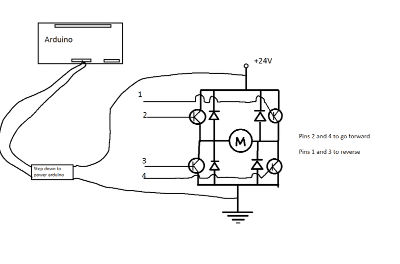

Hello
I'm trying to radio control a 24V 250W DC motor using Arduino. Instead of buying a real RC ESC I thought I might as well build an H-bridge myself and learn something along the way. I was thinking that I can use some logic level MOSFETs like the IRL7833 or something similar (this one is probably overkill but I don't know that much about MOSFETs).
This is my attempt at making one. The alternatives on ebay made me wonder if I missed something though.
http://www.ebay.co.uk/itm/Semicondu...315558?hash=item3f3b267466:g:c9oAAOSwbqpT6a8z
That chip next to the half-bridge acts as an extra enable switch or something as I understand it. Is this correct? What do you reckon that capacitor is for? Do I need these extra components or will the circuit I made work? What do I do about the diodes if I want electrical braking? Any diodes that you can recommend for this?
Answers are appreciated as always! :oldbiggrin:
Edit: If I don't use electrical braking for this I suppose I could just connect 1 with 3 and 2 with 4 so that I only use 2 of the Arduino's PWM pins
You must have some logic level voltage shifting for the high-side switch transistor gate drive.
You must make sure that the two switches on one side are never still conducting at the same time.
Turn on both low-side switches to get electric braking.
The BTS7960B is an integrated half bridge driver that handles the gate drive level conversion and locks out series switch conduction.
The chip next to the switches is a 74HC244 which is a dual 4 bit line driver – receiver.
The capacitor probably provides for high current peaks and so keeps switching noise from the power supply lines.
http://www.instructables.com/id/Motor-Driver-BTS7960-43A/
https://cdn.instructables.com/ORIG/FYD/V3VU/HUL8W2ZW/FYDV3VUHUL8W2ZW.pdf
Likes mheslep
Can't the Arduino control a logic level MOSFET on its own?
I could add pull-down resistors and a delay between the forward and reverse state and then just pray that the Arduino doesn't fail. I don't know any other way to do it.
Okay, that's clever. I could have used these instead but there are no BTS7960B's on ebay, I have to buy an assembled motor driver.
Thanks for the answer btw
Oh and I can't see why the line driver is needed. Won't this circuit work with the adjustments that you pointed out?
The high side switch gate cannot be driven if the positive supply voltage is above the Arduino logic supply.
See; http://www.egr.msu.edu/classes/ece4...e Regarding H Bridge Design and Operation.pdf
BTS7960 is now replaced by better version called BTN7960, available on ebay. It is probably still cheaper to buy the built controller.
Tristate line driver probably takes data from arduino on 4 pins and returns status data on the same 4 pins.
Thanks for that pdf! Golden. I don't fully understand the schematic at the end but everything else was clear.
It is a little sad that having the skills to make something doesn't pay off
The capacitor and gate driver are added to trigger the high side MOSFETs then.
I don't know if I want to attempt building this right now because it will cost a lot more. The gate drivers alone will cost more than the assembled motor driver so..
For what it's worth I understand now though, so thanks! :D
