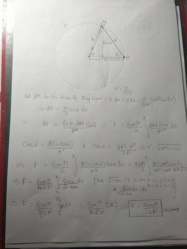

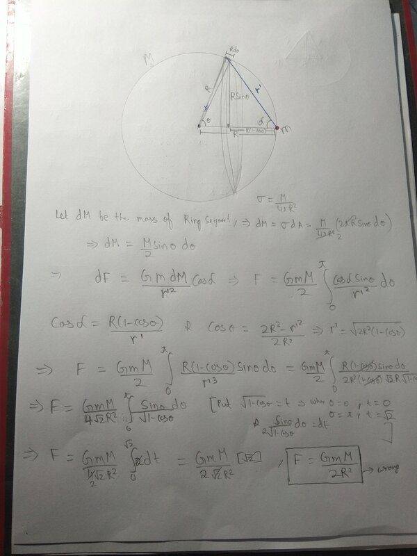

While deriving newton shell theorem for a hollow sphere of mass M , radius R and a point particle of mass m at a distance r, i am getting wrong answer while taking r=R (ie particle on the surface of spherical shell) Please tell me where i am going wrong.

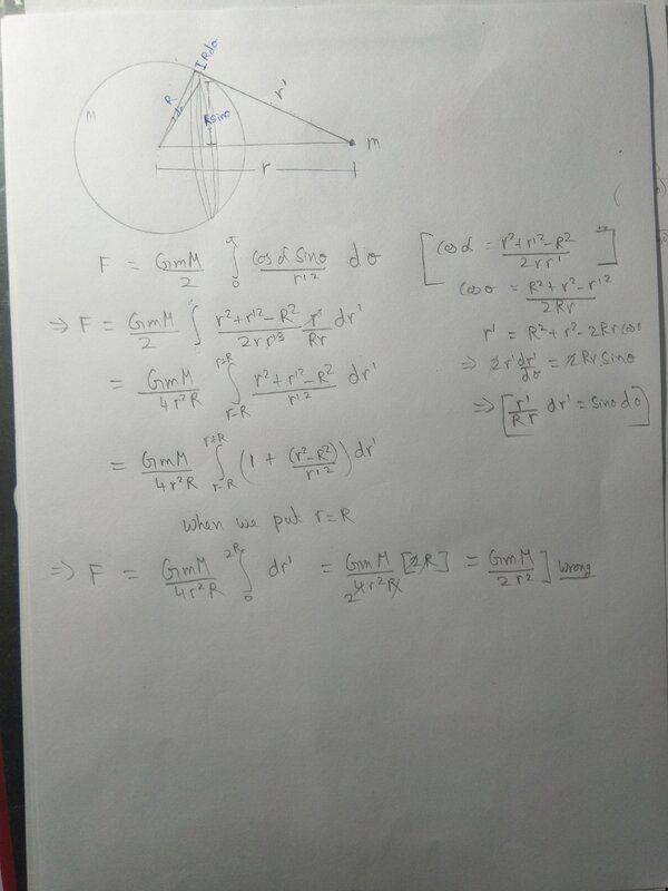

F = ##\ (GmM/4r^2R)\int_{r-R}^{r+R}((r'^2+r^2-R^2)/r'^2)dr'##
First i tried proving Newton shell theorem directly for r=R and solved the integral as above but still got the wrong solution.
Here i tried using general case:
Here r' is the distance of a small ring from the point particle of mass m
So my doubt is when we take r=R and then evaluate this equation, limit goes from 0 to 2R and integral gives the value (GmM/2r^2)
Which is wrong, so where am i going wrong?

I believe the "relevant equation" is dimensionally incorrect ?
Yep i had written r'instead of r'^2 and dr instead of dr', now its been edited
The result is O.K. The "paradox" arises from considering an infinitely thin layer of mass. Inside the shell (r<R) the field is zero; just outside the the shell is GM/R^2. There is "jump" from zero to a finite value. On the surface, the result is the average of the values inside and outside.

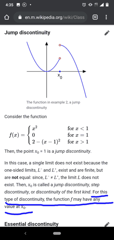

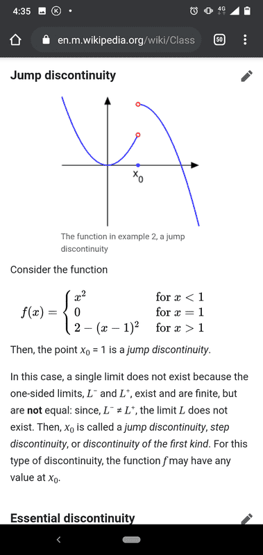

@PeroK ,@vanhees71, it seems this is the case of jump discontinuity
And still our solution manages to give average value, how cool is this?
