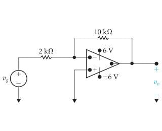

Find Vo as a function of Vg and the open-loop gain A.
Attempt
I'm not sure what open-loop gain means.
I redrew the circuit so it made more sense to me, but I'm still not getting it. It seems that Vo is the voltage across both RL and the 4k resistor.
The voltage across the 4k resistor is equal the voltages at the input terminals.
Aside from these bits of information I don't really know how this thing operates. Should the current going into the input terminals still be 0? But at the positive terminal the current is 8/50k right? or does this mean there is a -8 voltage source after the 50k resistor?

It probably means the op amp gain by itself (no feedback or input components). Ground one input, apply a signal to the other input, the OL gain = output/input.
Yes. The op amp is ideal except for finite gain.

Why? Vo=10/2Vg=5Vg
Since it is Inverting amplifier

Because you have ignored the finite gain of the amplifier (the "open-loop gain A").
Your expression holds only if the amplifier gain is infinite.

I think I'm right. It's is inverting amplifier, so the closed-loop gain (Acl) independent of the op amp's internal open-loop gain (Aol)
Acl=-Rf/Ri where Rf is feedback resistor, Ri is input resistor
→Vo=-10Vg/2=-5Vg
