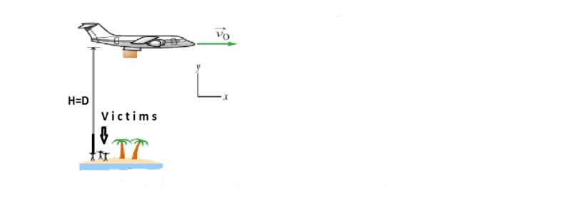

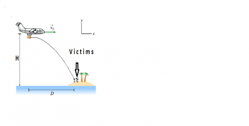

A helicopter on a flood relief mission flying horizontally with a speed vo at an altitude H, has to drop a food packet for victims standing on the ground. At what 'distance from the victims should the food packet be dropped'?the victims are standing in the vertical plane of the helicopter.
In my textbook diagram for this problem is given
(a)
but what i am confused about is why victims are standing there, can't they stand just beneath the helicopter like this (b)
after all ,victims are standing in the vertical plane of the helicopter in this picture also .So 'distance from the victims should the food packet be dropped 'is equal to height H .That's what i thought and chose the option H as answer for this MCQ.But in my textbook 'distance from the victims should the food packet be dropped' i.e D is taken as in Picture (a) and hence solved this problem in totally different way.So what is wrong in picture b ,victims are still in the vertical plane of the helicopter as mentioned in the question.please do reply.

I think you are confused by the fact that a helicopter is mentioned. It seems like since the problem statement mentions a helicopter and you don't see a helicopter in the figure, you are ignoring other parts of the figure (such as the fact that the vehicle in question is not hovering over the survivors). I think it'd be reasonable for you to assume that the helicopter/plane is not hovering over the survivors. Then this becomes a non-trivial (in that you have to use at least one equation) projectile motion problem.
I recommend you use figure a. Assume the vehicle is some lateral distance away from the survivors when it drops the package.

Ah ok. In that case I understand your confusion more. However the problem statement does say the helicopter is flying horizontally. This means that the package will be moving both horizontally and vertically upon being dropped. So the helicopter cannot be directly above the survivors at the moment it drops the package. In your (second) diagram, the package would miss the survivors since it would move horizontally at the speed of the vehicle. The vehicle needs to be located laterally "before" the survivors. Find that distance.
