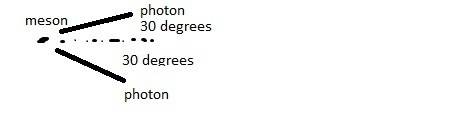

In summary, the homework statement is that a meson decays into two photons, each at 150 MeV in its rest frame. Find the KE of the meson if the photons decay at an angle of 60 degrees between them.
Chip90
55
A meson decays into two photos, each at 150 MeV in its rest frame. Find the KE of the meson if the photons decay at an angle of 60 degrees between them.
I have attached a picture for reference.
Pi=Pf and Ei=Ef
So for Pi=Pf I used
Pi= gamma*m*v
Pf= 2*h*(w/c)*cos30
where gamma is 1/(1- [v^2/c^2])^(1/2); m is mass of meson; v is velocity of meson
h is Planck's constant; w is angular frequency; c is speed of light; cos30 is for angle between photon and meson's path
i think mass of meson is 300Mev/c^2= 3.33e-9 eV/c^2 but this could be wrong since its not going at c
not sure what velocity is or how i find it
So for Ei=Ef
Since E^2=(mc^2)^2 + (pc)^2
Ei=[(mc^2)^2 + (pc)^2]^(1/2)
Since E=h*w
Ef=2*h*w
[(mc^2)^2)+(pc)^2]^(1/2)=2*h*w
So I then substitute h*w from momentum for gamma*m*v*c/sqrt(3)
then square both sides
(mc^2)^2 + (pc)^2=4*m^2*v^2*c^2/3
I am not sure if I am going in the right direction with this. I still don't know what is v for original meson. Thanks for the help

Looks okay. What is p equal to in your last equation? Write it in terms of m, v, and gamma, and you should be able to solve for v.
this p in this? that would be the momentum of the meson, which is gamma*m*v so
m^2*c^4 + gamma^2*m^2*v^2*c^2=(4/3)*m^2*v^2*c^2
not sure what do to now.. is the mass correct that i calculated? if so, why, it isn't traveling at the speed of light, yet that equation would hold? (i mean that dividing Mev by c^2 gives mass)..
Yes, the mass is correct. In the rest frame of the particle, all of its mass is converted into energy of the two photons. Just because c appears in the units doesn't mean the object is moving at the speed of light. In fact, because it has mass, it can't move at the speed of light.
In your most recent equation, you can write gamma in terms of v, so the only unknown left is v. Solve for it. Once you have that, you can calculate the kinetic energy of the meson.

The mass should cancel. You seem to have accidentally dropped the γ on the righthand side when you squared the equation. If you fix that, I think you'll get it to work out.
ok, can't believe i missed that.
now i tried it again and get 0.72c
so how do i get the ke now?
do i just use
KE= (gamma -1)*m*c^2 ?
Calculate the meson's total energy and subtract off the rest energy. What's left over is the kinetic energy.

No, K=E-mc2. Also, it's better to keep the answer in units of MeV. For particle physics, it's a much more convenient unit than joules.
ok so then I get 132MeV. Does that sound right?
and thank you so much for your help so far.. I've been a little stuck on it
No. You should find the kinetic energy is equal to the rest energy.

Yes. What did you find for E? What did you get for γ?
I got E is 431.86 MeV and gamma is 1.44
Recheck your calculation of γ.

Looks like it. I got v/c=sqrt(3)/2. Is your v actually v2?

You need to recalculate γ. You're still using the value for v/c=0.72.
oh no, you're right gamma is actually 2
so
E=601.5 MeV
KE=301.76 MeV
That seems correct..
Just a question, what mattered if they separated at a higher angle, isn't the point of the problem to show that Energy is conserved?
For a different angle, you'd find the energy of the photons have changed. It changes in exactly the right way so that both total energy and momentum are conserved.
Another way you can solve this problem is to look at it initially in the center-of-mass frame. You can immediately write down the energy and momentum of the photon in this frame. You can then calculate the Lorentz boost required to get the desired angle for the photons' momenta in the lab frame. That same boost applied to the meson would allow you to calculate its energy.
