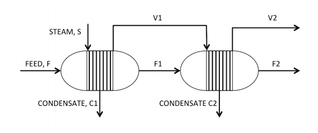

I have identified that only the specific enthalpy for stream F can be found from literature values, whereas the specific enthalpy of other streams are unknowns.
The specific enthalpy of streams S, V1, C1, C2 and V2 are unknowns because the temperature is unknown. On the other hand, specific enthalpy of streams F1 and F2 are unknown because the composition of NaOH is unknown.
May I know if I am correct?

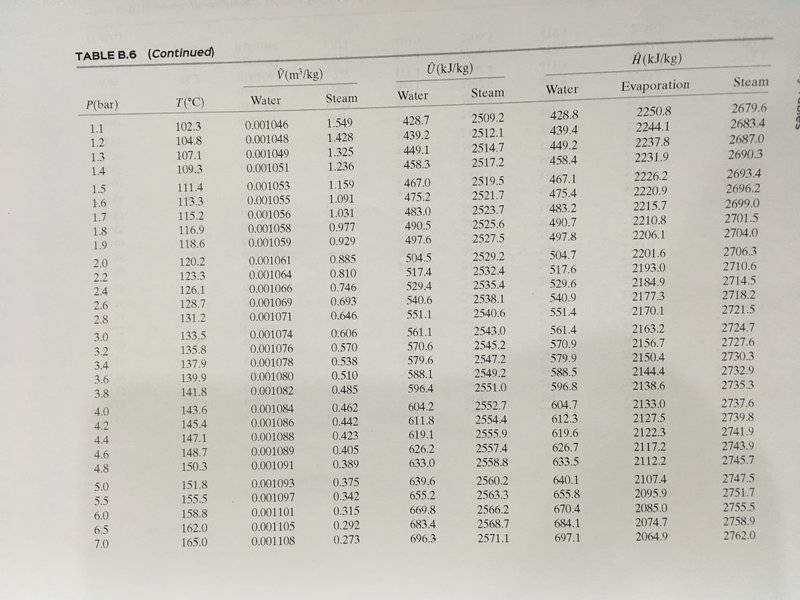

I just realized that I can get the specific enthalpy of stream S at 3.5 bar, by interpolating from 3.4 bar to 3.6 bar from from this table:
Table1: Properties of saturated steam: Pressure table

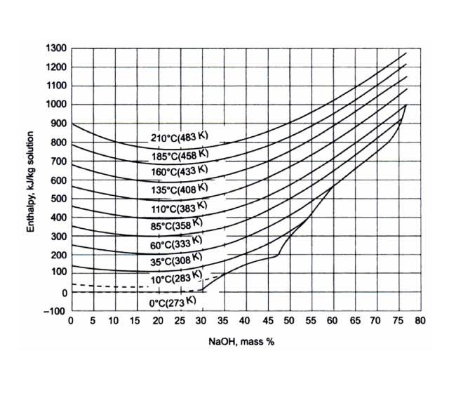

Chart1: Enthalpy of NaOH solution given mixture boiling temperature and mass fraction.

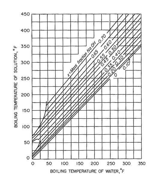

Chart2: Boiling temperature of an aqueous solution of NaOH given the mass fraction and temperature of the boiling water.
For streams V1 and V2, I assumed that the temperature of the steam is 100 degC, or assume that the pressure is the same as the evaporator (50kPa) so I can find it from the literature values, though I'm not sure if my assumption is valid.
For streams F1 and F2, the specific enthalpies can't be found because we don't know how much of steam is evaporated and so we don't know the w/w% of NaOH solution in these streams.
However, can the specific enthalpies of streams C1, C2 be found? The temperature and pressure of these streams are not known so I'm guessing we can't unless we assume the pressure of C1 is 50kPa, but I'm not sure if this assumption is valid.
To know the specific enthalpies of streams C1 and C2, you need to know their temperatures and pressures. But shouldn't these be the same as the temperatures and pressures of V1 and V2?

Sry one more thing.. how do we know the boiling point of water at 10w/w% NaOH solution?
Chart 2
