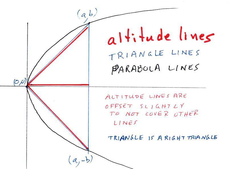

Looking at your post #8 it looks like one of the options from problem statement might be correct . Is it so?

There is no confusion except perhaps on your part. NONE of the answers are correct as I showed in post #20. What is confusing about that?
And my solution is not correct because ... ?
What solution? You mean that picture of the parabola in post #25? The question wasn't whether it was possible to have the orthocenter be at the (1,0). You aren't given the points are symmetric in the axis.
From your earlier posts I assumed you agree there is no correct answer to the badly stated problem, and the only person confused about this is the OP.
[Edit] corrected vertex to (1,0).

"origin" was one of the possible answers. My solution gives the origin. Why is that not correct?
  • #31
EDIT: and by the way, see post #8[/QUOTE]

Because the question didn't ask whether it was possible for the orthocenter to be the origin. It gave three arbitrary points on the parabola and asked which answer was correct for the location of the orthocenter. As my example in post #20 shows, the orthocenter can be outside the parabola in which case none of the answers are correct. You have shown a particular collection of points having orthocenter at the origin, but there is nothing in the problem that specifies that the points must be symmetric to the axis of the parabola as yours are.
  • #33
See post #8 and the one it was responding to.
  • #34
HallsofIvy is incorrect that the orthocenter must be inside the triangle. See my post #20.

Well, my interpretation and solution do not imply that the orthocenter MUST be inside triangle, although it certainly CAN be inside. My solution in fact has the orthocenter ON the triangle (and on the origin). The interpretation here is that they are saying there ARE three point that have one of the possible solutions as the correct answer and that's what my solution does.
