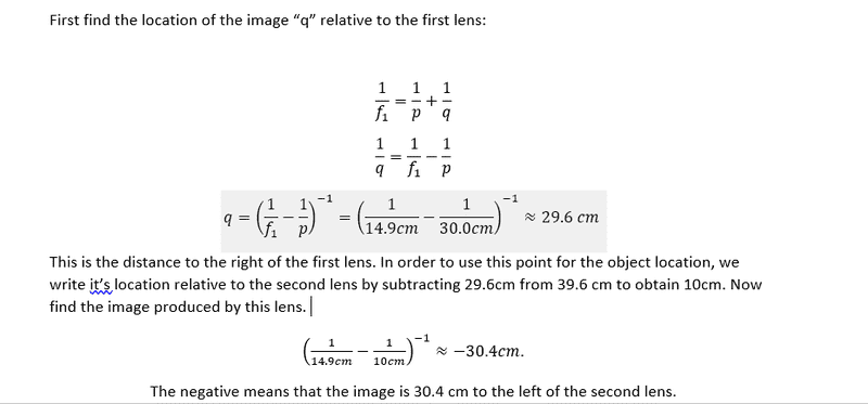

[tex]\frac{1}{p}+\frac{1}{q}=\frac{1}{f}[/tex]
I already had this typed in word so here is a screen shot:
I don't understand why the negative is omitted in the "correct answer" "B." In solving this problem I wanted to proceed in finding the image location relative to the first lens, which should be 9.2 cm.
The diagram does not define the axes so the sign is arbitrary.
