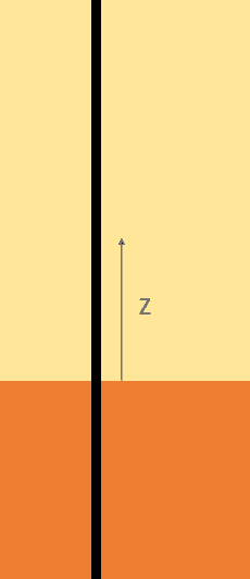

Some context on the problem:
We have an open magnetic flux tube that originates in the solar interior and continues on towards the outer solar system (to be precise at some point it will have to return because there is no net loss of magnetic field lines from the Sun, all lines have to come back, but for our purposes we can assume it goes off to infinity).

I have pictured in my mind the magnetic field line (when observed over time) like an elastic band that can carry waves.
We know that the domain is (0,+∞)(0,+∞).

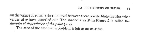

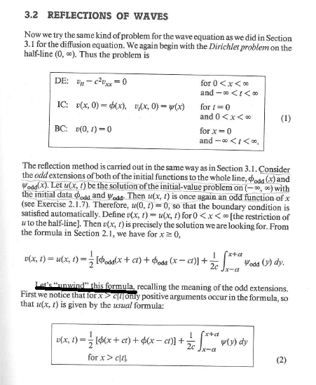

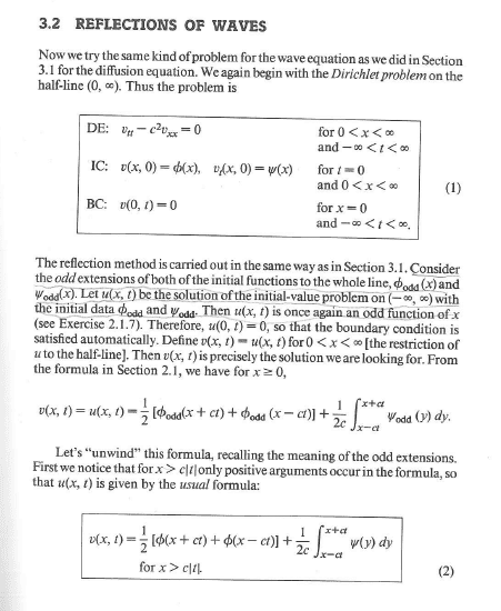

OK so I am studying the solution method (method of images) given by the nice book Introduction to Partial Differential Equations by Strauss. I will post it and then ask questions.

2) Odd extension (I won't explain why odd and not even; I'll just state that when you're dealing with Dirichlet BCs you have to use odd extensions, and when you're dealing with Neumann BCs you have to use even ones; more details see section 5.2 of PDE book by Strauss) and final solution
The odd extensions are defined as follows:
ϕodd(x)=​
⎧⎪⎨⎪⎩ϕ(x), for x>0−ϕ(−x), for x<00, for x=0​
ϕodd(x)={ϕ(x), for x>0−ϕ(−x), for x<00, for x=0
ψodd(x)=​
⎧⎪⎨⎪⎩ψ(x), for x>0−ψ(−x), for x<00, for x=0​
ψodd(x)={ψ(x), for x>0−ψ(−x), for x<00, for x=0​
The book says that the final solution is given by the following pair:
f(x,t)=12[ϕodd(x+ct)+ϕodd(x−ct)]+12c∫x+ctx−ctψodd(y)dyf(x,t)=12[ϕodd(x+ct)+ϕodd(x−ct)]+12c∫x−ctx+ctψodd(y)dy
f(x,t)=12[ϕodd(ct+x)−ϕodd(ct−x)]+12c∫ct−xct+xψodd(y)dyf(x,t)=12[ϕodd(ct+x)−ϕodd(ct−x)]+12c∫ct+xct−xψodd(y)dy​
For x>v|t|x>v|t| and for 0<x<vt0<x<vt respectively.
My issue is that I do not understand why. I get lost in what Strauss calls the 'unwinding of D'Alembert solution' (pages 59, 60 of the book).
Please let me know if you need me to include more details.
Let me attach the images:
I get lost in what Strauss calls the 'unwinding of D'Alembert solution', as I do not really see why he's checking out the cases ##x > c|t|## and ##0 < x < ct##
NOTATION NOTE: he uses ##c## instead of ##v## and ##u(x, t)## instead of ##f(z, t)##
