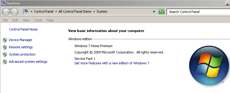

Which version of Windows is it?
That may be difficult to tell - post mortem - after applying the splitting maul. :D
thanks for the reply

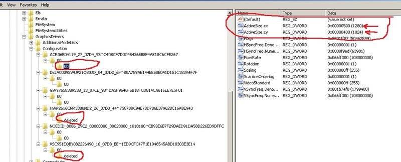

On the premise that two different programs are trying to set up the monitor differently during the wakeup process
I tried removing conflicting monitor resolutions in REGEDIT by renaming any that weren't 1280X1024 to DELETED ( so they'd be easy to restore)
i did them one or two at a time
in hopes that would render them unusable to the operating system
to no avail
maybe i'll try renaming all but one and see what happens.
i have no idea what those things do

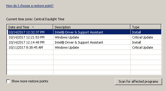

Sounds as if that update might be 'a' or 'the' culprit.
Windows creates restore points when installing anything, meaning we can undo the update, if only to verify if it was causing the problem.
A quick google shows me this and this.
Alternatively, we can boot in such a way that only the bare minimum of drivers and programs are activated, and we can selectively indicate what else we want to start.
That way we can verify if the problem is caused by faulty drivers or software.

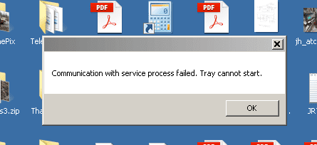

Started up fine this time except for this piece of ambiguity
Maybe my last tweak on the registry entries did something - will advise after a few more starts.

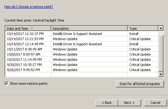

It's liveable but annoying . Complaints at microsoft community site about this date back to least 2009.
Don't think i have a restore point early enough.

For the record, I do see a checkbox labeled Show more restore points...

HKEY_LOCAL_MACHINE\SOFTWARE\Microsoft\Windows\CurrentVersion\Run Renamed all four entries to "NoLonger--old name" so can put them back
That may not be good enough.
The key names are irrelevant - it's about the Data that's behind them that identify the programs that are supposed to be started.
I usually use File/Export to export the entries so that I might import them again, after which I delete everything in there.
(And I have never felt the need to import anything again. ;))

system seems to be noticeably better now.i think i'll delete those things @I like Serena suggested deleting
and go back & un-rename the ones i did on my own up in Regedit Graphics list one at a time
