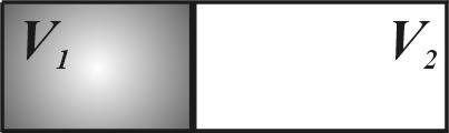

An adiabatic isothermal process can be only irreversible, so the entropy change is positive. Consider for example the following situation
Diagram of a rectangular box divided by a vertical wall into two chambers, the left labelled V1 and shaded grey, the right labelled V2 and empty white.
The box is made of adiabatic walls, and in the left hand side there is an ideal gas at temperature T. If we remove the black inside wall then the gas will fill all the space. Since the walls are adiabatics [tex]Q=0[/tex], and no work is done [tex]W=0[/tex], from the 1st law of thermodynamics we have
[tex]Q=\Delta U+W\Rightarrow \Delta U=0 \Rightarrow n\,C_V\,\Delta T=0 \Rightarrow T=const.[/tex]
Thus the process is adiabatic and isothermal but irrevesible.
In order to calculate the entropy's change, since we cannot apply [tex]\int^{f}_{i}\frac{dQ}{T}[/tex] we use the fact that entropy is a state funtion as Hootenanny posted.
That means we can imagine an revesible processure which has the same initial and final states. That could be an isothermal from the volume [itex]V_1[/itex] to the volume [itex]V_1+V_2[/itex]. The heat for this process is [tex]Q=n\,R\,T\,\ln\frac{V_1+V_2}{V_1}[/tex],so
[tex]\Delta S=n\,R\,\ln\left(1+\frac{V_2}{V_1}\right)>0[/tex]

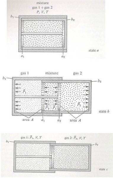

[tex] <br /> I was not referring to any particular process. But if you want one consider the reversible separation of gases by mean of semipermeable membranes. There you will find an isothermal adiabatic reversible process.[/tex]

First of all, sorry because I didn't mean to say Gibbs's paradox. I mean reversible separation of gases. which, in any case, deals with ideal gases. Here you will have an adiabatic isothermal reversible process and even more: with no work! [tex]dQ=dW=dU=0[/tex]; and is a closed system. What else do you need? As I suspect you are more interested in discussing than in understanding my arguments, I have decided to attach a picture of the page of the Atkin's book which explain this. The figure showing the arrangement is also attached.
I think with this, discussion is over and it is clear and laid-down that there is adiabatic isothermal reversible processes.
