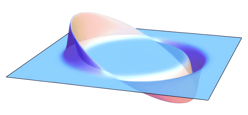

What would be the easiest way to plot a space-time curvature from a metric as a curved 2D surface. For example the Alcubierre metric would be plotted with the result as in the attached image.
The mathematical programs I have at my disposal right now are Maple, Matlab and Mathematica. I'm much more used to using the two former ones though.

The figure you attached is a plot of the volume factor versus spatial position. I'll work through it with you in Maple starting tomorrow.

The Maple code below reproduces the famous Alcubierre warp drive plot.
Explanation to follow.
Code:
f := r -> (tanh(sigma*(r + R)) - tanh(sigma*(r - R)))/(2*tanh(sigma*R));
g := D(f);
sigma := 8; R := 1; vs := 1;
plot3d(vs*x/sqrt(x^2 + y^2)*g(sqrt(x^2 + y^2)), x=-2..2, y=-2..2, style = PATCH, grid=[100,100]);

I have played with this in the past and found the following code gives a nice 'warp drive' in matlab.
[x, y] = meshgrid([-10:.3:10],[-10:.3:10]);
for i=1:length(x);
for j=1:length(x);
z(i,j)=-1*(tanh (2*sqrt(abs(x(i,j)^2+y(i,j)^2-16)-5)+3)-tanh(2*sqrt(abs(x(i,j)^2+y(i,j)^2-16)-5)-3))...
*tanh(6)*x(i,j);
end
end
mesh(x,y,z)
axis([-10 10 -10 10 -10 10 -10 10])
view([158,26])
colormap(hsv)
Major difference being that I multiply by the (2*tanh(sigma*R)) term instead of dividing.
Interested to hear any thoughts on this...
