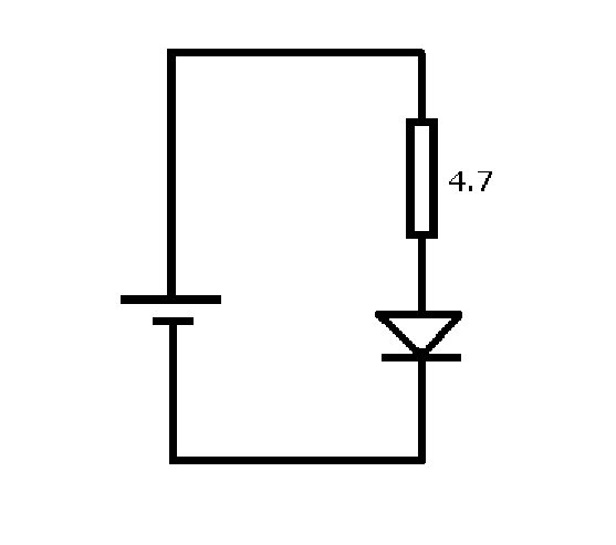

If you bought the batteries together and you fully discharge them before charging, there shouldn't be a problem charging them in series.
If they are being used in a digital camera, they will still have a lot of charge in them when the camera stops working. So they have to be discharged carefully.
In this circuit, the diode plays an unusual role. It limits the final voltage that the single NiMH cell drops to. The current is limited by the 4.7 ohm resistor. When the battery voltage drops to 0.6 volts, the current will stop and the battery is discharged as far as it is safe to do.
Then you need a timer to make sure you do not overcharge the batteries. If they overcharge, they will get hot and may be destroyed. This is not really dangerous but it is expensive.
