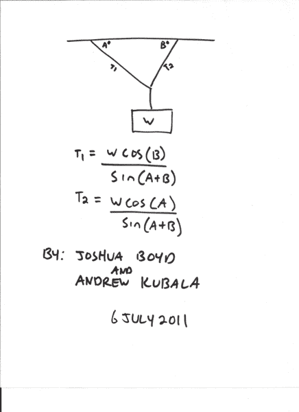

A new formula for solving simple tension problems involving a weight suspended by two cables with tensions T1 and T2 and angles A and B has been proposed. The formula aims to provide a quicker solution to these types of problems, although some participants believe it may not be particularly innovative or useful. The discussion includes a proof that illustrates the potential time savings when applying this formula. Overall, the community encourages exploration of new approaches in physics problem-solving. This formula could offer a fresh perspective on tension calculations.
Soenhay
A quick shortcut for problems that involve a weight (W) hanging from two cables with tensions T1 and T2 and angles A and B.
Probably not that useful.
Probably already known.
But just in case here it is:

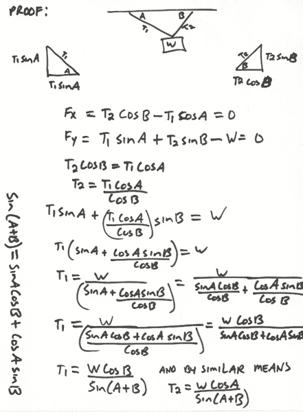

The following is the proof which also shows how much time one might save:
Hello Soenhay and welcome to Physics Forums.
That's a neat little formula, I don't think I've seen it put that way before so keep at it you never know what you might come up with next.
:smile:
