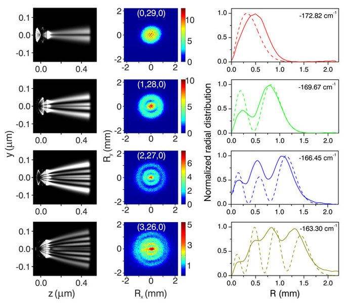

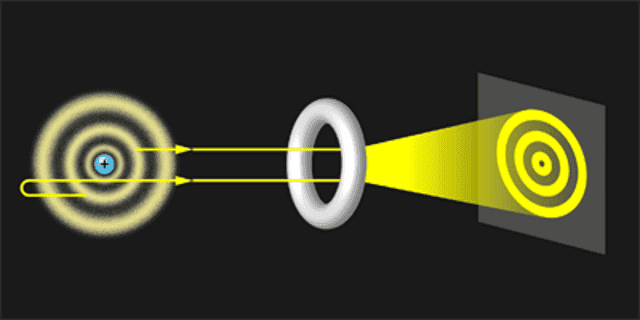

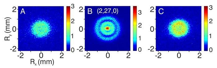

And why not indulge ourselves with some images?
A photoionization microscope.
Images of nodal structure.
