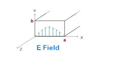

Hey guys. I'm trying to comprehend the TEmn EM fields in wave guides. I've gone through the derivation, using Pozar's microwave textbook, and for the most part it's straight forward. I am having a hard time though determining what the effect of the imaginary factor in the field equations are.
Here is the simplest case, a TE10 wave propagating in the z direction, with a picture of the waveguide dimentions and the E field as I would imagine it to be.
The E and H fields are given as:
E_{y} = \frac{-jωμm\pi}{k^{2}a} A sin\frac{mx\pi}{a} e^{-jβz}
H_{x} = \frac{jβm\pi}{k^{2}a} A sin\frac{mx\pi}{a} e^{-jβz}
I understand there is a dependency on z from the e^{-jβz} factor.
I also understand there is a time and frequency dependancy (not shown) from e^{jωt} factor.
But what I'm really trying to understand is, how does the factor, \frac{-jωμm\pi}{k^{2}a} , effect the fields?
I'm not sure how I should tread the imaginary factor in this case.
Thanks a lot.

Thanks emi guy, but I think you missunderstood what part I was asking about. I got that there is an assumed factor e^{jωt}, but what I didn't understand was the first factor, colored red, in the Ey field equation below.
Ey(x,y,z,t) = Re [\frac{-jωμm\pi}{k^{2}a} A sin\frac{mx\pi}{a} e^{-jβz}e^{jωt}]:
I've been thinking about it though, about what it's affect on the E field is. If you could tell me if I'm right or not I'd be grateful.
Using the identity: j = e^{j\frac{\pi}{2}}
The Ey field becomes:
Ey(x,y,z,t) = Re [\frac{ωμm\pi}{k^{2}a} A sin\frac{mx\pi}{a} e^{-jβz}e^{jωt} e^{-j\frac{\pi}{2}} ]
which is
[\frac{ωμm\pi}{k^{2}a} A sin\frac{mx\pi}{a} cos(\omegat - βz - 90°)
which will just delay the phase 90° as the wave propagates along the z direction.
Hope I'm on the right track. Thanks!
