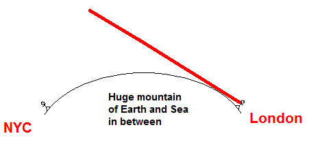

the rest of what you said was OK but the above statement ISNT the ONLY issue
read my posts, the curvature of the Earth IS THE ISSUE
good grief guys, stop over thinking the problem ... Its not rocket science
its purely a curvature of the earth/line of sight ( or lack of) problem
Dave

I suggest YOU reread his first and following posts ... its pretty obvious that he's referring to
why they can't see each other or a strong light that's being shone towards the other person over a very long distance
In my opinion was interested in the effects of light through the atmosphere over a long distance and light propagation. I mentioned the curvature, but didn't consider it pertinent to the issues he was confused about. I also suggested he solve for the amount of light curvature due to the mass of the Earth. I'm surprised you got confused about the context of my "the only issue". You seem fixated on what YOU think is a big deal that you think no one understands. I suggest you re-read the OP and deal with his other misunderstandings.
I stand by what I wrote earlier ... the OP doesn't understand light's straightline path. and he doesn't seem to comprehend how the curvature of the Earth is the MAIN reason for not seeing each other or the light from a long distance
Lights on the Earth's surface have no problem traveling through the atmosphere and into space and visa versa. Yes there is some absorption but not so much as it stops the light by any significant amount
Dave
