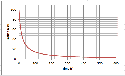

The motivation is to maximise the use of a fixed power supply (other details below), though my original question asked what you now ask me to specify, i.e. to define more precisely in what way the rocket should be efficient.
Here's the rocket specification: A rocket engine is provided with a constant power supply of W watts and its function is to accelerate a rocket payload of mass M to a speed V. The time to do it is unlimited and the initial propellent mass is also unlimited. The rocket must eject mass as the same speed as the rocket wrt the rocket however (zero speed relative to an inertial observer), which in turn means the rocket must be supplied with some initial momentum. This momentum would be some initial value that is also to be determined. What is the equivalent of the rocket equation for this rocket? It could be an unrealistic rocket but doesn't seem so to me at present, though it could well be impractical. From this I can compare it to the usual rocket equations and gauge efficiency of this versus say the standard rocket equations that you mention, with a constant and maximal exhaust velocity.
What I have discovered so far from numerical simulation: The momentum of the rocket remains constant during the flight, i.e. what was provided to it initially. Its acceleration remains constant. At the risk of using the word efficient, all the energy seems to end up in the rocket and none in the exhaust, so something interesting efficiency-wise may be occurring here. Is this not spookily interesting in it own right even if the rocket isn't efficient in any way? Its acceleration and time to reach a deltaV is dependent on initial conditions (power, initial mass and initial momentum). Propellent exhaust speed wrt to the rocket increases with time (with a constant acceleration) as does the rocket speed. The momentum supplied to the rocket decreases with time.
Since the acceleration is constant, we can easily work out the time to reach the target delatV. Likely all the final values and its performance characteristics can be determined easily in closed form, but I don't have a rocket equation yet.

My propellant isn’t standard rocket fuel, it’s just any mass that is in large supply. It could be moon dust for all I care (perhaps plasma engines will be able to eject that one day!).
Anyway I think I have answered my own question to my satisfaction now (though could be wrong), and the answer turned out to be simple:
Noting that the momentum of this rocket is conserved at all times: Mf * Vf = M0 * V0
[M = the total mass of the rocket at any time, V = Velocity of the rocket, subscripts f = final, 0 = initial)
Therefore Vf = (M0/Mf)*V0
So for example to get the rocket up to 30,000 m/s with a starting velocity of 10m/s, (M0/Mf) would have to be 3000! Not propellant efficient, but that wasn’t a limiting condition and is only one example where the starting velocity is low.
Similarly noting that my power supply is constant and that all the input energy ends up in the rocket (I am not confident about this assumption) and that energy = power * time, therefore the time to reach a particular mass ratio can be formulated. And from that an equation of motion, or a rocket equation, could be created I think. I’ve not created it yet though as am a bit unsure about my assumptions. A bit of a non-vigorous, non-standard approach, but oh well, it works for me for now.

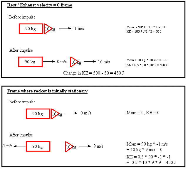

Problems, great!
Unfortunately I only have time to address the first one, let me know if it's still there after I reply to that one.
Okay, let’s try an example. As the inertial frame I have been using leaves the propellant stationary after the burn, I’ll do the calculation as a single impulsive burn in that frame and then switch to another to see if everything all ties up, okay? The first frame is where a rocket has some small speed and the second frame I pick will be one where the rocket is initially stationary which I think is your preference. I won't use my formula on that one, I'll switch frames manually. It will probably need two diagrams to follow the below.
First frame: Initial mass (M0) =100 kg, speed (V0)= 1 m/s, final mass(Mf)= 10 kg. So these are the inputs to my little formula Vf = (M0/Mf)*V0, which comes to 10 m/s. So the momentum of the rocket before the burn was 100 kg * 1 m/s and momentum after = 10 kg * 10 m/s. We have used 100-10=90 kg propellant and in this frame the propellant has zero momentum and energy. The energy of the rocket in this frame was 50 J and is now 500 J. We used 450 J of energy.
Second frame: In this frame the rocket was initially stationary and after the burn is moving at 9 m/s, and is 10 kg afterwards as before. The rocket momentum before the burn was zero and after the burn is = 10 kg * 9 m/s. The propellant (90 kg as in the first case) was stationary before the burn and is now moving at 1 m/s, so its momentum = 90 kg * 1 m/s. Momentum is conserved. The energy of the rocket before the burn was 0 and after the burn is 0.5 * 10*9*9=405 J. The energy is the exhaust = 0.5 * 90 *1 * 1=45 J. Total energy = 450 J. Same as in the first case.
I'm not sure if I can get my head around creating a frame independent version of my formula at present, but switching frames manually seems to work out.
To accelerate a 10kg mass to increase the velocity by 9 m/s by expelling mass, the energy spent decreases as the amount of ejected mass increases. The total energy output can be less that 450 J if the ejected mass is greater than 90 kg. Using the second frame of reference with an initial velocity of 0.
EM = Ejected Mass = 180 kg @ 0.5 m/s
Initial momentum = 0
Final momentum = 10 kg x 9 m/s - 180 kg x 0.5 m/s = 0
Initial energy = 0
Final energy = 1/2 x 10 kg x (9 m/s)^2 + 1/2 x 180 kg x (0.5 m/s)^2 = 405 J + 22.5 J = 427.5 J
EM = Ejected Mass = 360 kg @ 0.25 m/s
Final momentum = 10 kg x 9 m/s - 360 kg x 0.25 m/s = 0
Initial energy = 0
Final energy = 1/2 x 10 kg x (9 m/s)^2 + 1/2 x 360 kg x (0.25 m/s)^2 = 405 J + 11.25 J = 416.25 J
EM = Ejected Mass = 900 kg @ 0.1 m/s
Final momentum = 10 kg x 9 m/s - 900 kg x 0.1 m/s = 0
Initial energy = 0
Final energy = 1/2 x 10 kg x (9 m/s)^2 + 1/2 x 900 kg x (0.1 m/s)^2 = 405 J + 4.5 J = 409.5 J
Using the first frame of reference for the 900kg case:
Initial energy = 1/2 x 910 x 1^2 = 455 J
Final energy = 1/2 x 10 x 10^2 + 1/2 x 900 x .9^2 = 500 + 364.5 = 864.5 J
Increase in energy = 864.5 J - 455 J = 409.5 J
This is the same reason that gliders and other efficient aircraft use long wing spans: to accelerate a greater mass with a lesser change in velocity.
As for required power, the required power decreases as time increases. Say the constant power available is 450 watts applied for 1 second. Then the energy output is 450 J, and the example using 90 kg for the ejected mass in the prior posts would apply. Consider what happens if the time is doubled to 2 seconds. Now the energy output is 900 J, allowing for a much smaller mass to be used. In this case the ejected mass is 90/11 kg ~= 8.182 kg, and the velocity of the ejected mass is -11 m/s.
initial momentum = 0
final momentum = 10 kg x 9 m/s - 90/11 kg x 11 m/s = 0
initial energy = 0
final energy= 1/2 x 10 kg x (9 m/s)^2 + 1/2 x 90/11 kg x (-11 m/s)^2 = 405 J + 495 J = 900 J

I liked these insights so much that I have come back again.
I have given further thought to your point about reference frame dependence in my solution and I think one answer would be to introduce a second variable to hold the starting frame velocity, which is subtracted from the rocket velocity in the equation. Or indicate that the rocket velocity is relative to a frame the rocket was in prior to it being given its initial momentum, i.e. its starting frame, which is also the frame in which the exhaust velocity is zero.
willem2 said:
only optimal if you have just the right amount of reaction mass and energy...is simply not enough energy to accelerate it all to the required velocity
The propellent mass ejected per unit time isn't constant in my solution, but the power is constant. The reaction mass/s goes as 2*ConstPower/RocketVelocity^2, so the propellent can always be ejected with full power. The reaction mass/s gets smaller as it and the rocket get faster and lighter. A sample plot from a run using my rocket equation that I have created but won't post until it is tested:
Below is what I had in mind:

My examples are easiest to understand if using the "second frame" as the frame of reference, where the rockets initial speed is zero. The 10 kg rocket always ends up at 9 m/s with 405 J of energy, so the only variable is the amount of energy that the ejected mass ends up with, and this energy decreases as the ejected mass increases. The impulse is always the same, +90 kg m/s for the 10 kg rocket, - 90 kg m/s for the ejected mass. Assuming the time period is the same, then the Newton third law pair of forces have the same magnitude regardless of the amount of ejected mass. If the time is 1 second, then the magnitude of each of the forces is 90 Newtons.
Yes, you are right. Nothing was making sense to me in the end, wrong frame. Back to the drawing board for me tomorrow. Cheers!
Hmm, another day and I’m back to thinking my ‘global frame’ may not be wrong after all! Could I trouble you further. First for ease of expression below can I define two frames, one called the ‘global frame’, which is the frame where the rocket started with zero velocity and a second frame called the ‘rocket frame’ where the rocket always has zero momentum. My preference is the first frame and your preference is the second, I think.
I see that you are a programmer, and if you were to program a rocket numerically would you not employ a global frame? Even if the calculations are done in the rocket frame, the result would have to be converted to a global frame at some stage? So a global frame shouldn’t really be too out of the ordinary or the cause of anything unphysical occurring? It’s just for ease?
The rocket frame is great for simple intuitive calculation for an impulse as you have shown, and your burn in the rocket frame shows a low exhaust speed in that frame, and in one example it was zero is the global frame too (-1 m/s in the rocket frame) which was promising. But the problem to my mind comes with subsequent burns in a rocket frame that is moving and accelerating in the global frame, because this is the one I am interested in. And the reason for that perhaps unusual perspective is because my question revolves around knowing if a zero exhaust speed in the global frame, along its entire path, is 100% energy efficient. A low exhaust speed in the rocket frame may not be a low speed in the global frame on subsequent iterations.
Are you able to do multiple burns in the rocket frame while keeping the exhaust speed at zero in the global frame? Or is that unphysical?
My preference is for an inertial frame where the initial velocity of the rocket is zero. In this frame the rocket moves one way, the ejected mass the other way, but the center of mass of the rocket + mass never moves. In any inertial frame, the center of mass of the rocket + mass moves at constant velocity, I choose a frame where the constant velocity is zero. The "rocket" frame is an accelerating frame, which makes it more complicated to calculate momentum and energy changes.
