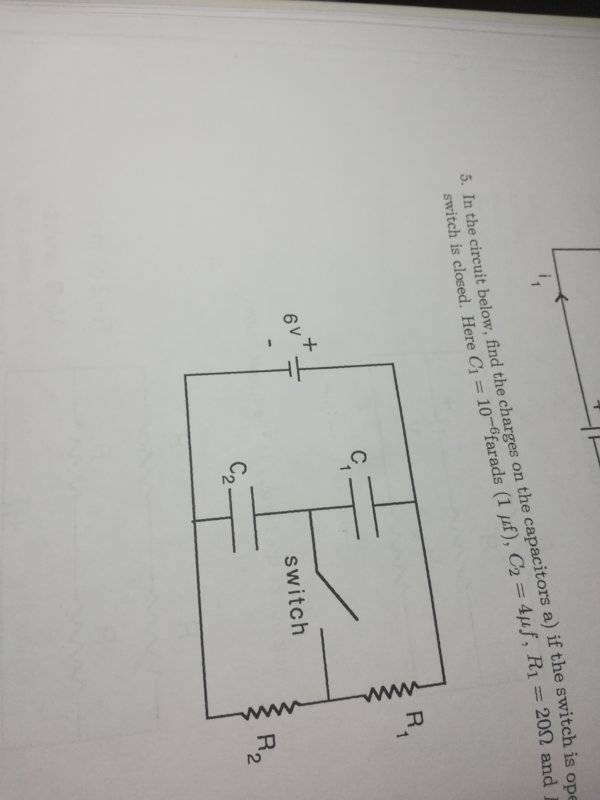

In the circuit below, find the charges on the capacitors a) if the switch is open, b) if the switch is closed. Here C1 = 1 microfarads, C2 = 4 microfarads, R1 = 20 ohms and R2 = 40 ohms.
V = iR
Q = CV
I already did part a and got the correct answer of 4.8 microC. However, I am unsure how to approach part b, where the switch is closed and apparently the two capacitors end up with different charges. For part b, since there is a path between the two capacitors, I don't know if I am able to combine the two capacitors into an equivalent capacitor. According to the textbook, the solution is that Q1 is 2 microC and Q2 is 16 microC. Any help is appreciated.
Hi,
Well, what do you get for the voltage over C1 if you apply your first relevant equation ?
(after you determined -- qualitatively -- what happens with the current through the switch when it is closed and afterwards :smile:)
I think I got it, thank you.
With the answers given it's a piece of cake :smile:
