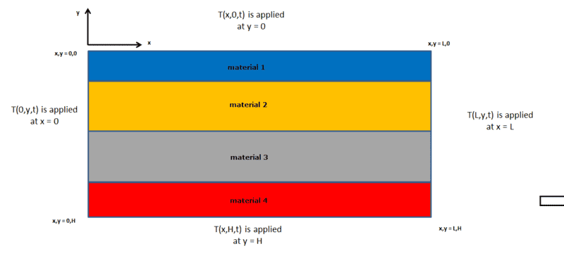

Hi, I am trying to formulate a 2D model to calculate the temperature change over time in a composite material.
The material consists of several layers, and is heated from all edges by a known temperature vs time profile.
I was thinking of creating a finite element model.
Can someone point me to a similar example? I have done 1D conduction model before but always with a homogeneous material. Do I just have to create nodes throughout and assign different material properties to each?
I have attached a schematic of what I am trying to describe.
Thanks
  • Schematic of a rectangular domain of width L and height H made of four horizontal layers labelled material 1 (blue), material 2 (yellow), material 3 (grey) and material 4 (red), with boundary temperatures T(x,0,t) at y = 0, T(0,y,t) at x = 0, T(L,y,t) at x = L and T(x,H,t) at y = H.

To do the problem as you've defined it, then yes, you have to do it pretty much the way you described. I would be more inclined to use finite difference than finite element.
Chet
Thanks Chet, I will give it a try with finite difference method.
