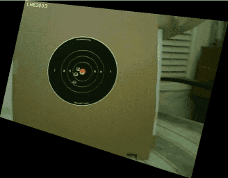

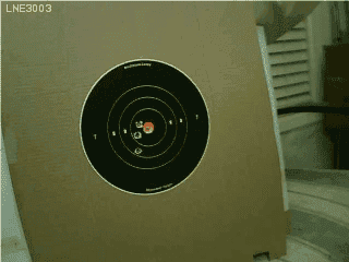

I've attached "before" and "after" images to illustrate the image transformation.
I am currently using Mathematica's FindGeometricTransform function to get the 3x3 matrix and then I'm using Mathematica's ImagePerspectiveTransformation to transform "before" into "after". The transformation compensates for the fact that the camera is placed out of the line of fire, from which perspective the target is no longer circular. After the transformation, the target is once again circular.
CSS is a styling language for the web. The most recent version introduces 2D and 3D transformation of items on pages. I want to place the "before" image on a web page then set the image's transform attribute to either a CSS matrix(...) or matrix3d(...) construct. I want to use the 3x3 matrix Mathematica gave me, but matrix(...) only allows one to specify the first two rows, which is why I'm looking at matrix3d(...).
If you're interested in the CSS details, this page is probably as good at explaining it as any other. But my question is really about how to extend this sort of 2D 3x3 transformation matrix into a 3D 4x4 transformation matrix that leaves z unchanged.
I.e. if
a b c
d e f
g h 1
transforms (x,y) to (X,Y), what's the 4x4 matrix that would transform (x,y,z) to (X,Y,z)?
