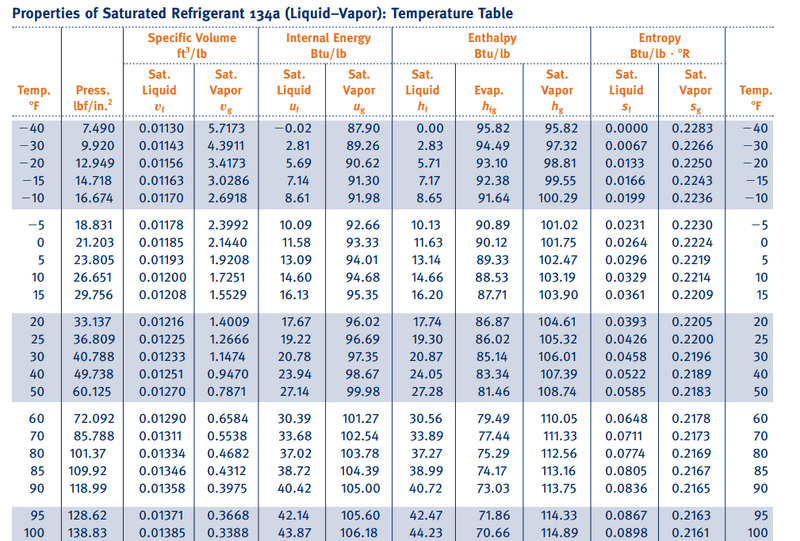

I'm confused about the $$v_{Lf}$$ and $$v_{Vf}$$
The final specific volumes of the saturated liquid and vapor.
