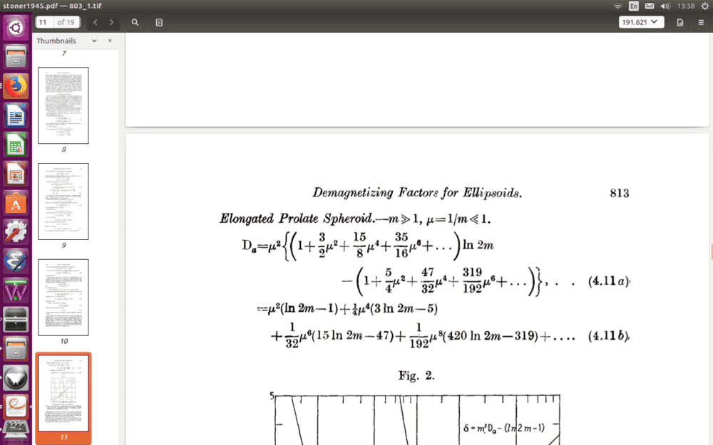

In the attachment in eq. (1.6) I don't understand why is ##H-B = B/(1-D)##?
Where does this relation come from?

##H=-D(B-H) ##. They got that part right. Let's do some algebra: ##H(1-D)=-DB ##, so that ##H=\frac{-DB}{1-D} ##. Their last equation of 1.6 needs a minus sign. ## \\ ## Note: Equation 1.6 assumes the applied magnetic field ## H_a## is zero. ## \\ ## And I also checked equation 1.7, and it is correct.

On page 11 in the following attachment in eq. (4.11a) for ##D_a## after the first equality should it be ##3/4\mu^4 \ln (2m)## or as it is written there?
I am asking since after the second equality they write it as ##3/4 \mu^4 \ln (2m)##.
It looks to me like it should be 3/2, but I would have to see the previous page. Clearly they have an inconsistency there.
