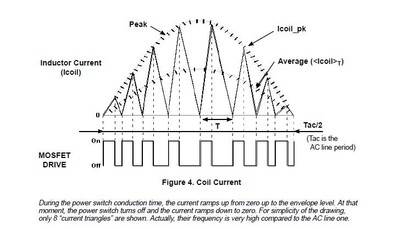

For good power factor correction at the input to the SMPS, you want to follow each half-cycle of the AC voltage and draw the average current in a direct ratio to that input voltage. That makes the input characteristic look (mostly) resistive, with Iin = Vin/Reff. Because you are still doing switching on the input current waveform, there will be some harmonics generated, but usually with just a little bit of high-frequency filtering, you can meet the regulatory limits for harmonics on the powerline.
The PWM of the current at the input stage looks something like this, in order to draw an average current from the powerline that is tracking the input voltage waveform. I use this technique in my Boost input stages for PFC power supplies:
http://cr4.globalspec.com/PostImages/200911/PFC_current_waveform_18F5EAD9-CA6B-5E4E-250950656C4D83E6.JPG
Ok so as I understand it, we use a switcher that chops the sine wave up without any capacitive filtering ahead of the switcher and run the switcher in boost mode to get a high voltage DC supply. But surely unless we run switcher so that the duty cycle is much larger when the sine wave is close to zero we will have a lot of 120 hertz ripple. Something needs to fill in the area between peaks. A plain old capacitive filter after the rectifiers would always place heavy current draw in the area on the sine wave that moves away from zero. I can see where the above scheme changes that but don't we simply do it twice as often? So the result would be an improvement in power factor but aren't we prone to adding a harmonic to the line at 120 Hz (USA).
Exactly the same thing happens with a bridge rectifier and filter cap directly connected to the line. There is an inrush current to charge the cap every time the line voltage exceeds the cap voltage. Both configurations are a non-linear, harmonic load. The switcher, fed from unfiltered rectified line voltage, puts the switching transients at the higher switching frequency (easier to filter) rather than at twice line frequency. (and you can use a smaller transformer, but need a bigger filter cap on the output)

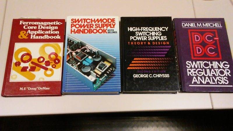

How versed are you in feedback system design? Closing the control loop of an SMPS (or multiple loops) is a significant part of the design.
These are the main textbooks that I have used in my work... (plus of course many App notes from control IC vendors) :smile:
