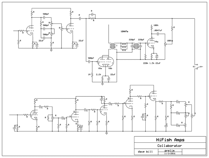

Here is the very preliminary concept schematic of the preamp section. The channel switching will be controlled by a relay at K1.

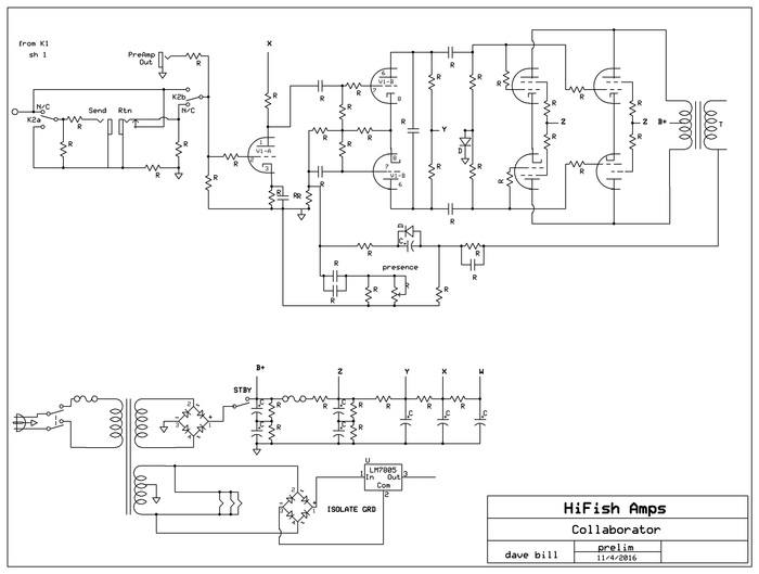

Here is the prelim PA.
I am considering adding a DC heater to the first preamp tube.

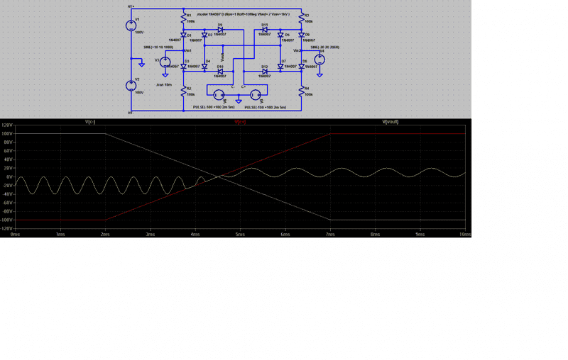

Diode switches can switch slowly and quietly because you can control the rate that the diode current changes.
I have worked with valve equipment since the late 1960s and so I know the problems to be expected when mixing valve and semiconductor technology. Have you ever seen a balanced diode switch?
Planobilly; What have you got against the balanced or symmetrical diode bridge for switching signals quietly?
This circuit, if built with 1N4007 diodes, will survive any commercial valve amplifier circuit.
