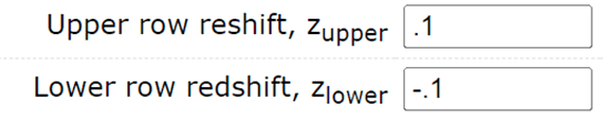

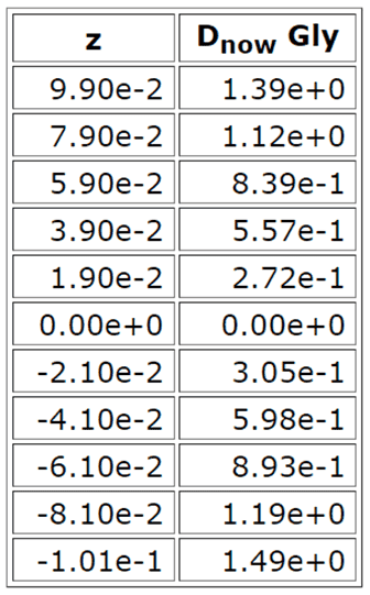

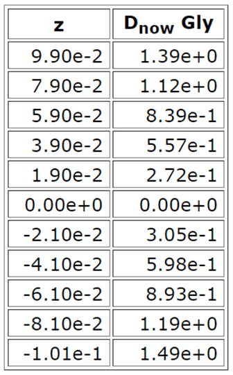

I will look at it tonight. I noticed the following:
When specifying the following:
I got this:
The ranges of z values seem not consistent.

OmegaL = 0.691            # OmegaL control
Omega = 1                 # Omega control
z_eq = 3370               # z_eq control

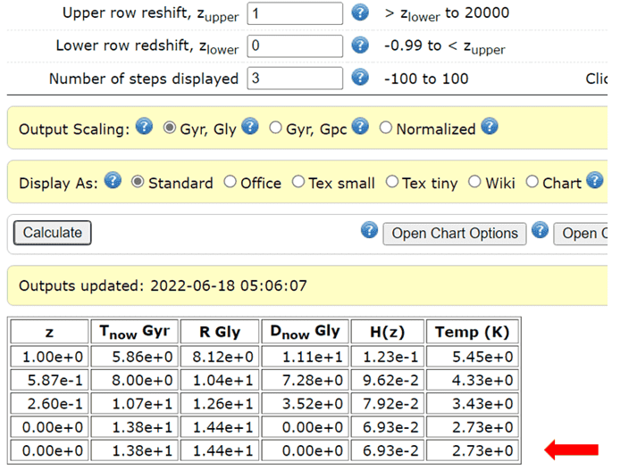

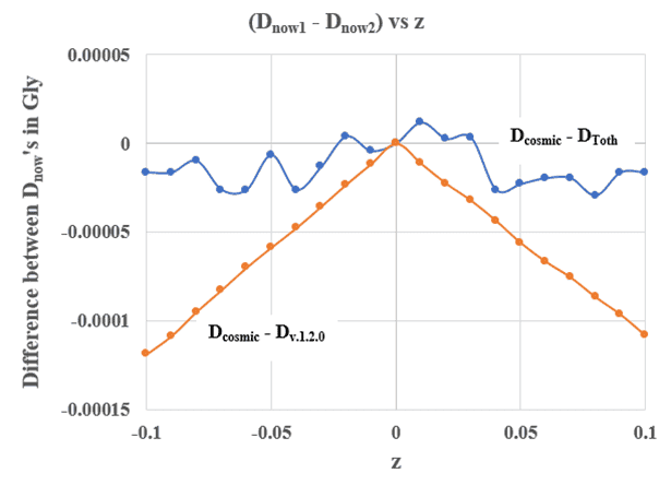

First, the output z range is still different from the input z range:

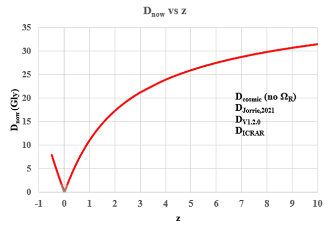

I did the following experiment:
If I calculate Dnow using Gnedin's and your 2022 calculator and plot 'DGnedin - DJorrie' vs z, I expect to see points fluctuating around the Dnedin - DJorrie = 0 line. But I got the following result:
I wonder what clues we can get out of this.
Hi Jim, yes there is that difference, but that's not the problem, the inputs range must just be a little larger than the output range. As long as the distance now output is correct for the displayed z, that's acceptable for now.
For a trial, I've just subtracted 0.001 (line 274 in the 2022-05-14 version) from the output z in order to cancel the origin's horizontal offset, which is caused by the way the distances are computed in the legacy algorithm. The question is: are those (new) values correct? Perhaps you can check it against Gnedin's.
I know that this is not the right way to handle it, so we should be investigating a purer algorithm, like @Ibix is looking at. My own time is slightly limited atm, but I will keep watching and contributing as it hopefully develops as a community project.
Thanks for contributing!

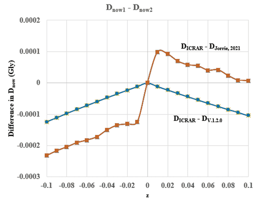

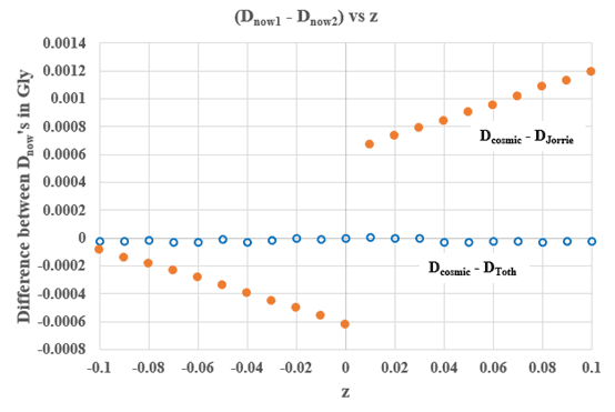

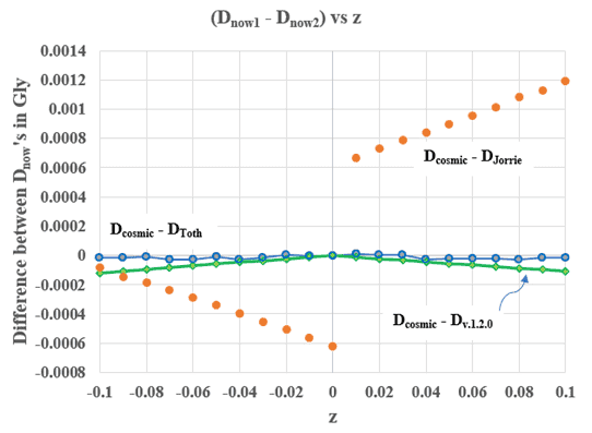

Would you please calculate the following Dnow values using your calculator so I can do some comparison?
z
Gnedin
Jorrie, 2022
ibix
0.11.410041.4084
0.091.272141.270609
0.081.133541.132106
0.070.994260.992931
0.060.854270.85305
0.050.71360.712477
0.040.572250.571225
0.030.430230.429278
0.020.287480.286651
0.010.144080.14336
000.000621
-0.010.144740.14526
-0.020.290150.290567
-0.030.436230.436536
-0.040.582950.583161
-0.050.730320.730433
-0.060.878340.878358
-0.071.026991.026926
-0.081.176311.176124
-0.091.326231.325968
-0.11.476791.476416

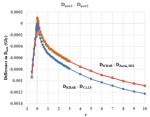

I am puzzled by the plot shown in Post #36.
  • #45
I think the puzzles will go away if we get the distances algorithm sorted out.

That sounds like a good idea. Thanks for calculating the Dnow values! A comparison is shown below:
zGnedinJorrie, 2022ibix
0.11.410041.40841.41
0.091.272141.2706091.27
0.081.133541.1321061.13
0.070.994260.9929310.994
0.060.854270.853050.854
0.050.71360.7124770.713
0.040.572250.5712250.572
0.030.430230.4292780.43
0.020.287480.2866510.28
0.010.144080.143360.144
000.0006210
-0.010.144740.145260.145
-0.020.290150.2905670.29
-0.030.436230.4365360.436
-0.040.582950.5831610.583
-0.050.730320.7304330.73
-0.060.878340.8783580.878
-0.071.026991.0269261.03
-0.081.176311.1761241.18
-0.091.326231.3259681.33
-0.11.476791.4764161.48
If we plot the three Dnow vs z curves, they are just about indistinguishable. If we add the (DGnedin – Dibix) result to the plot shown in Post #36, we get the following:
In general, (DGnedin - Dibix) fluctuates around the y = 0 line. The greater deviations from the line near the two ends are probably due to round-off effect of the calculated Dibix. I am still puzzled by the slightly different behaviors of the two data sets.
