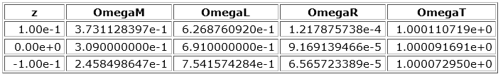

Hi @Jorrie and @pbuk,
I noticed some discrepancies in results from LightCone8. Let’s use the following input values:
Equations in Tutorial, part III,
Ωm = (Ω - ΩΛ) Seq / (1 + Seq), where Seq = zeq + 1​
ΩR = Ωm / Seq
give,
Ωm = 0.308908363
ΩR = 0.000091637
These numbers are compared with output of LightCone8 below:
z
OmegaM
OmegaL
OmegaR
OmegaT
LightCone8
0​
0.309000000​
6.910000000
0.00009169139​
1.000091691​
From Equations
0​
0.308908363​
6.91​
0.000091637​
1​
Note that under Conversions in the output, LightCone8 gives,
Conclusion: The values of Ωm and ΩT calculated with LightCone8 are questionable.
  • #106
  • #107
Would you please let me know where in Jorrie 2021 calculator the circled number shown below is calculated and printed, for example, lines numbers in Calculation.js. I am trying to understand the discrepancy discussed in Post #105.
  • #108
It is calculated in the main html program, not in Calculate.js
line 356 var OmegaM = (Omega-Ynow * Ynow / Yinf / Yinf) * s_eq / (1+s_eq);
I'm not sure if this should have been "z_eq / (1+z_eq) "
Also take note that it is expressly rounded to 4 decimals for that calculation.
When calculated later in the tables, it is rounded to the requested number pf decimals.
Ps: The densities for the tables are calculated in
Calculation.js line 27: var Om = (Omega - Ol) * (s_eq + 1) / (s_eq + 2);
The (s_eq + 1) / (s_eq + 2) is a mistake that has been prviously pinted out and corrected in Lightcone8 by @pbuk. There is some further processing in lines 243 to 250.
These line numbers are only relevant to the LightCone7-2021-03-12 Version
  • #109
Jorrie said:
It is calculated in the main html program, not in Calculate.js . . .
Thanks! This is helpful. The situation is that using the same input, two different values of Ωm,0 are obtained from the calculator, 0.3089 from the main html program and 0.3090 from Calculation.js:
This suggests that there is an error in the calculator program. @pbuk
  • #110
I think the error is in the UI: we should have ## \Omega_{m,0} = \Omega - \Omega_{\Lambda,0} = 1 - 0.691 = 0.309 ##.
  • #111
In Calculation.js:
var Ok = 1 - Om - Or - Ol; // curvature density par
  • #112
I have checked the UI calculation and it seems to be right if radiation density is included, as it should.
##\Omega_{m,0} = 1-\Omega_{\Lambda,0} - \Omega_{r,0}= 1 - 0,691 - 0,000091637 = 0,308908363##
I obtained the value of ##\Omega_{r,0}## by substituting ##\Omega_{m,0} = S_{eq} \Omega_{r,0}## into the balancing equation.
On the other hand, if I set the columns for enough decimal places in Ligtcone8, ##\Omega_{T,0}## does not equal 1.
So the error seems to lie in calculation.js for the columns.
  • #113
It's the same in LightCone7 (bar imprecision)
this isn't surprising as I've used essentially the same calculation as LightCone7
JavaScript:
          rholNow = rhocritNow * Ol;
          rhol = rholNow;
          rhomNow = rhoNow - rhol;
          rhom = rhomNow *s*s*s;
          rhorNow = rhomNow/s_eq;
          rhor = rhorNow *s*s*s*s;
i.e. ## \rho_{m,0} = \rho_{0} - \rho_{\Lambda,0} ##. I guess you are saying this should be ## \rho_{m,0} = \rho_{0} - \rho_{\Lambda,0} - \rho_{R,0} ##?
There's a few other oddities I'm coming across, I think I'm going to end up rewriting the physics from scratch (which means I'm going to have to learn it first!)
  • #114
Yes, at any time, ##\rho_{0} = \rho_{r,0} + \rho_{m,0} + \rho_{\Lambda,0}##. In the case ##\Omega = 1##, this is subject to the constraint$$\rho_{0} = \rho_\mathrm{critical} = \frac{3 H_0^2 }{8 \pi G},$$
since ##\Omega := \rho/\rho_\mathrm{critical}##.
  • #115
Yes, the same differences occur in Lightcone7, but it is calculated differently than the value in the UI. I will check that part and make it compatible, because I still feel that the value in the UI is correct.
  • #116
Minor corrections (red) in Calculation.js required to improve the issue:
var Ol = (Ynow / Yinf) * (Ynow / Yinf); // Lambda density parameter
var Om = (Omega - Ol) * s_eq / (s_eq + 1); // matter density parameter (corrected for radiation)
var Or = Om / s_eq; // Radiation density parameter (corrected for error; was /(s_eq+1)
rhol = rholNow; // vacuum energy density remains constant

In Lightconne 7, it gives the correct matter density of 0.308908 at z=0 and a more accurate OmegaT. The drift in OmegaT may be rounding off in Lightcone 7. It will be interesting to see what it does in Lightcone8 with its improved calculation module.

George, how do the equations change in the case where ##\Omega \ne 1##?
I'm asking because I don't think Lightcone7 gives the correct results in such a case.
