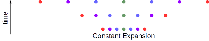

proxy.php?image=http%3A%2F%2Fi167.photobucket.com%2Falbums%2Fu124%2Fvalenumr%2Fconstant.png
I think it is an interesting thing to note, what Valenmur calls "constant expansion" is in some ways exponential.
After one period of time the distance from green to blue doubles. After another equal period, that distance doubles again.
The same can be said for the distance from green to purple, and for the distance from green to red.
Is that a standard description of what is meant by constant expansion?
I would probably represent that as dr/dt = k r.
dr/r = k dt
ln r = k t
r = e ^(kt)
r = r_0 * 2^t
Yes. It means that the first derivative of the scale factor is constant.
By analogy, this is the same as saying that your savings account is growing at constant rate of X% of compound interest, even as the actual amount of money grows exponentially.
Similarly, accelerated expansion means that the first derivative of a(t) increases over time. These are the meanings of acceleration/constancy/deceleration of expansion used in cosmology - not the change in velocities of individual galaxies.
By focusing on a single point in Valenmur's graphs and its motion with respect to the origin over the history of expansion, you may observe accelerated motion even as the expansion is decelerating.

  • #54
dr/r = k dt
ln r = k t
r = e ^(kt)
r = r_0 * 2^t
That is what I meant by constant expansion in this context, and your interpretation is exactly correct. By constant in this example, I mean space is expanding at a constant rate for all time, i.e. one (arbitrary) unit of space becomes two after one (arbitrary) unit of time. Because the expansion is a continuous process, this looks like an exponential. At the same time, you should also see that the recession rates are linear with respect to distance. So in this case, the redshift / distance graph would be a perfectly straight line.
So good question, because it really highlights all the key points I wanted to get across.
