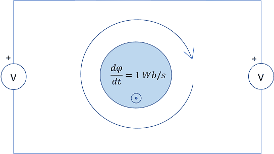

  • #31
rude man said:
Hope this isn't a duplicate, thought I had posted already, but:
So you assume a B field with finite extent and a circular path somewhere within that field?
Yes. A long solenoid creates the necessary uniform field in the z-direction, and by varying the current linearly with time, we have precisely the magnetic field we are looking for. If the only information given is that the magnetic field is uniform and into the paper, with ## \frac{dB}{dt}=## constant, you cannot solve for ## E ##. You need to know the location, (i.e. where the center is, etc.), inside the solenoid that is creating that field. There may be alternative ways to create it, but the long solenoid is the simplest and most readily available. ## \\ ## You can still compute the EMF around any circle without knowing the location, using Faraday's law: ## \mathcal{E}=-\frac{d \Phi}{dt} ##, ## \\ ## which is Maxwell's equation integrated over an area with Stokes theorem: ## \nabla \times E=-\frac{dB}{dt} ##, so that ## \int \nabla \times E \cdot \hat{n} \, dA=\oint E \cdot dl=\mathcal{E}=-\int \frac{dB}{dt} \cdot \hat{n}\, dA=-\frac{d \Phi}{dt} ##.

Let's see again. I still don't get this obvious contraction of fundamental math, in this case Stokes's integral theorem.
Let's do it once more: As usual, the local treatment is the most simple approach. You have given the (approximate) magnetic field
$$\vec{B}=\beta t \vec{e}_3.$$
Then we have
$$\vec{\nabla} \times \vec{E}=-\partial_t \vec{B}=-\beta \vec{e}_3.$$
The solution of this is
$$\vec{E}=-\beta \vec{r} \times \vec{e}_3-\vec{\nabla} \Phi,$$
where ##\Phi## is undetermined since the sources are not given.
For the EMF this is of course unimportant since any closed-loop integral over a gradient in a simply connected region (which is the case for the interior of the solenoid you are discussing) gives zero. Thus we have
$$\int_{\partial A} \mathrm{d} \vec{r} \cdot \vec{E}=\int_{A} \mathrm{d}^2 \vec{f} \cdot (\vec{\nabla} \times \vec{E}) = -\int_{A} \mathrm{d}^2 \vec{f} \cdot \beta \vec{e}_3.$$
For any (!) circle of radius ##R## parallel to the ##x_1 x_2## plane completely in the interior of your solenoid gives thus ##-\pi \beta R^2##. What's, in your opinion, wrong with this simple argument?
  • #39
vanhees71 said:
For any (!) circle of radius RRR parallel to the x1x2x1x2x_1 x_2 plane completely in the interior of your solenoid gives thus −πβR2−πβR2-\pi \beta R^2. What's, in your opinion, wrong with this simple argument?
I completely agree with it in the calculation of the EMF. What I was also expecting is that a computation of ## E ## would necessarily also follow from symmetry=(i.e. if the ## B ## field and ## \frac{dB}{dt} ## is uniform over the region of interest). As you pointed out, if the sources aren't provided, there is no guarantee that the problem has the necessary symmetry to be able to calculate the induced electric field ## E ##. ## \\ ## (I found this kind of surprising, but the example of a solenoid with the uniform magnetic field inside of it shows that the sources (and any symmetry they have and/or don't have) needs to be taken into account to compute the ## E ##).

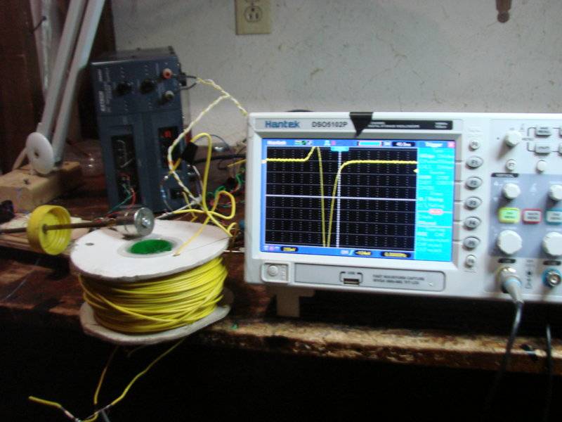

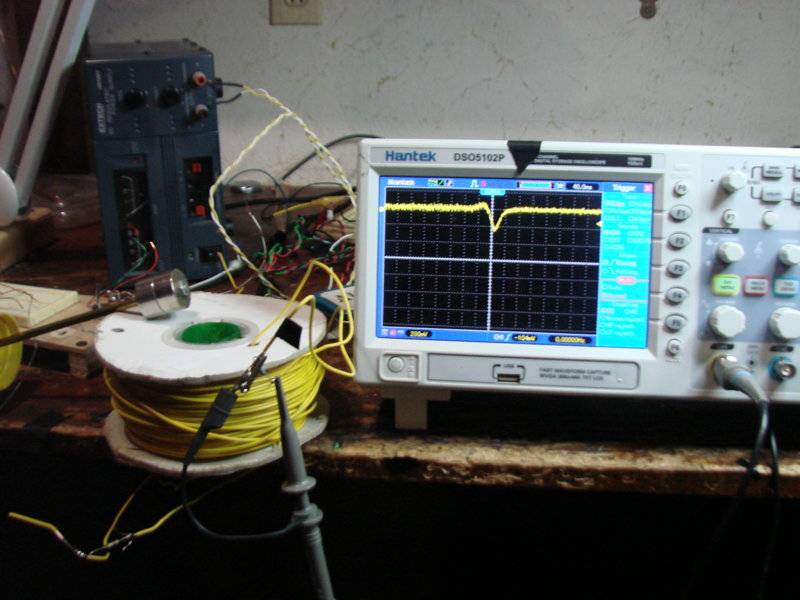

I did this experiment and it shows what Dr. Lewin stated. I took a 500 foot roll of wire used for dog fencing. ( it measured 5 ohms). Unspooled it, Cut it in half and rewound 250 feet back on the spool. I brought out a pigtail and connected it to a 1meg resistor. The other end of the resistor went to the 2nd 250 foot wire. I then wound the 2nd piece on the spool in the same direction. and connected a 100 K resistor to the beginning and end of the coil.
I put 2 strong magnets in the center of the coil and snatched them away and got a pulse on my Oscilloscope. The pulse on the 1 meg resistor was 10 times that on the 100 K resistor. I have 2 pictures and hopefully included them.

  • #52
Dr. Lewin's data was never in contention. That was not the issue. It's his explanations that were wrong, in particular the statement that "Kirchhoff was wrong". Kirchhoff's laws hold in all cases. They refer to voltage drops, which is not necessarily the same as measurements using voltmeters.
A voltmeters always correctly measures the voltages it "sees" but this voltage can be artificially induced by the voltmeter and its leads and is thus not the voltage in the absence of the voltmeter and its leads. For example, in Lewin's setup there is a voltage between any two points along a wire not including a resistor, yet the voltmeter reads zero.
The sum of voltages along any closed path is always zero irrespective of the nature of the emf generating them.
