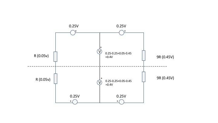

Walking clockwise through the loop, then the emf's have the right polarity, but the resistor drops are opposed to this direction. The sum will be ZERO
Using two voltmeters (in series) as in your "split" circuit, will give 0.2 Volts on each voltmeter.
For example, considering the upper left : 0.25 Vemf -0.05 Vdrop = 0.2V
and for upper right: - 0.25Vemf +0.45 Vdrop = 0.2 V etc...So the sum of both voltmeters will be 0.4 Volts and not 0.8 Volts!
Note that in the first (left) case your voltmeter Hi is connected to the positive side of the emf, but in the right case the voltmeter Hi is pointing to the negative side of the emf.
Hope this will help to understand also the rest of my video and thanks for watching it.
Best greetings from Belgium
Cyriel Mabilde
Now here is how I would solve this voltmeter problem: Let the EMF from the changing magnetic field be clockwise and 1.0 volt. Let the resistor on the left be ## R_1=100 \, \Omega ## and the resistor on the right be ## R_2=900 \, \Omega ##. Let the voltmeter across the middle be ## R_3= 1 \, M \Omega ## . Let the clockwise current through ## R_1 ## be ## i_1 ##, and the clockwise current through ## R_2 ## be ## i_2 ##. The downward current through ## R_3 ## is ## i_3 ##. ## \\ ## The 3 loop equations are: ## \\ ## 1) ## .5=i_1R_1+i_3 R_3 ## ## \\ ## 2) ## .5=i_2 R_2-i_3 R_3 ## ## \\ ## 3) ## i_1=i_2+i_3 ##. ## \\ ## A little algebra gives (eliminating ## i_2 ##) ## \\ ## ## 1.0=i_1R_1+(i_1-i_3)R_2 ## ## \\ ## and ## \\ ## ## 0=i_1(R_1-R_2)+i_3(R_2+2R_3)##. ## \\ ## The ## i_3 R_2 ## term can be considered small in two places, so that ## i_1=\frac{1.0}{R_1+R_2} ## and ## \\ ## the voltmeter reading is ## i_3 R_3=-\frac{1}{2}\frac{(1.0)(R_1-R_2)}{R_1+R_2}=+.4 \, volts ##. ## \\ ## @mabilde Thank you very much for your video. It was very interesting and instructive.
Cyriel Mabilde
And greetings to you from sunny Essex UK.
Thanks for your comment. (The demo on the video is great, btw) I obviously got the signs in my calculation wrong and, because I am familiar with Potential Dividers, I can do it in an easy way . Take the top left corner as reference zero for the first half of the calculation. The two resistors are a potential divider with 10:1 ratio. The upper voltmeter should be showing the unbalanced volts between the two nodes of 0.2V (= 0.25-(0.5/10)) Likewise the other voltmeter will see -0.2V, giving 0.4V overall.
It's been a long time since I did this stuff and I'v looked at the problem again. I should have written some reference letters on the diagram and it would be easier to discuss but @Charles Link has solved the problem in yet another way (with Kirchoff 1) - and got the same answer!.
@mabilde I am very glad you posted this video. The experimental apparatus and results is very interesting. I am also very glad that it showed the results that confirms a combination of Faraday's law, and Kirchhoff's voltage law.

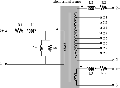

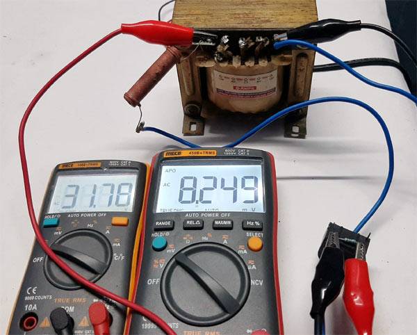

Lewin demo/paradox and general ordinary transformers are electromagnetic induction systems, so the working principle is basically the same.
Haven't the common transformers we use every day already shown that a voltmeter can be used to measure scalar potential in such systems?
Even though it is difficult to measure with a voltmeter in some cases like the Lewin demo/paradox, is there really no other way?

Averagesupernova said:
There is no magnetic flux passing through the pie shaped conductors that radiate out from the center of the solenoid and make contact with the single loop conductor in the @mabilde video. The flux lines cut lengthwise along those conductors.
I completely disagree. The pie-wedge shaped surface of the voltmeter loops are parallel to the ground. The magnetic field of the solenoid points straight up, at least in the interior of the cylinder he is measuring. The magnetic field therefore penetrates this surface at a perfect 90 degree angle, straight through. All he's measuring is the rate-of-change of this flux on his voltmeter.
Even though it is difficult to measure with a voltmeter in some cases like the Lewin demo/paradox, is there really no other way?I guess you mean that the electric field inside a perfect wire is 0. If the electric field in a region is zero, then of course there is no change in potential in that region. But note that this scale potential still acts on the wire surface and outer spaceSo isn't the voltage output by the transformer doing work on the load resistance?
When you measure the output voltage of a transformer (taking a voltmeter as the load that completes the circuit), you can analyze it two ways. If you draw a loop that passes through the interior of the conducting wire in the solenoid, The only voltage drop is across the load. The emf is provided by the changing magnetic field which penetrates the 'loop'. The loop is a bit hard to visualize as it consists of a corkscrew, but imagine a piece of rotini pasta. The field lines penetrate this surface once every turn, giving the net emf. In this analysis, there is no voltage across the transformer, just an induced emf, using Faraday's law to analyze the loop.
The other analysis loop consists of the voltmeter and a path that connects the terminals of the solenoid OUTSIDE the windings (hence outside the circuit). There is no flux which penetrates this surface, but there is an electric field that runs outside the solenoid, whose integral is equivalent to the induced emf. Using this loop, you could fairly refer to that electric field integral as a voltage, and use Kirchoff's law to analyze the loop.
Either way, on the load side you measure a voltage. You can think of this as the induced emf from the magnetic field, or a voltage between points directly outside the solenoid. The former is more physically correct I would say as it is the fundamental principle involved.
The scalar potential ignores the induced emf completely. It bases it's definition of potential solely on the electric field generated by the electrostatic distribution of charge at the ends of the resistor. So if the voltmeter is the only load, it has charge build up on the ends of it's internal resistor. This charge distribution creates a static field that cancels out the induced field in the wire, but concentrates in the resistor itself. The sum of this field ONLY adds up to zero around the loop, and as such you can assign a number, or 'potential' , to any point in the loop. But as this 'potential' ignores the induced emf completely, it has no relation to work on a test charge as it moves around in the solenoid windings. It costs nothing to move a charge from higher to lower 'potential' or vice versa along the solenoid path, and thus renders the concept of potential meaningless (mot to mention, this definition of potential or voltage does not agree with Ohm's law unless the resistor in question has zero length - in a circular loop for instance, if a resistor took up a quarter of the circles length, the static or scalar potential across it would differ from I*R significantly).
However, it DOES require to work to move a test charge through the load resistor. Hence it takes different amounts of work to move a test charge from one terminal of the solenoid to the other depending on which path you take. So if you define voltage between two points in the traditional way, as the amount of work-per-unit-charge required to move a test charge between the points - or equivalently Int(E.dl)- you find the voltage depends on the path taken, i.e. path dependence. This is what a voltmeter measures and why Lewin gets different readings on his voltmeters.
Compare this to a regular DC circuit with a battery and a resistor. Moving a test charge from one terminal of the battery takes the same amount of work whether you move around the circuit through the resistor, or on the other path directly through the battery - i.e. path independence.
The bottom line is that a charge only 'feels' electric field. It doesn't care whether a field is induced or electrostatic. Our standard definitions of voltage are based on force and work, and should therefore depend only on how a charge is affected, not on mathematical abstractions that have no physical meaning.
@tedward
Thanks to #29 for the informative and valuable reply, a great comment. I agree with most of the points. But there are still some points that I don't fully agree with.
We are now dealing with an electromagnetic induction system, and we assume that its total electric field is the result of the superposition of the induced electric field and the scalar electric field produced by the distributed charge. But the total E field of this system is actually a non-conservative field with no potential difference. Since every part of the overall system is interrelated and affects each other, I don't think that "The scalar potential ignores the induced emf completely".
I think no matter anywhere in the system, including in the solenoid winding or in the external load circuit, whenever there is current passing through the resistor, there will be a relative scalar potential difference and corresponding energy loss, so this scalar potential difference provides energy for the resistor (The scalar potential around the solenoid winding wire is more complicated, it may not be equal to the current times the resistance of the wire due to the induced electric field), which is one of its meanings in the system. It works even if the net electric field in the solenoid zero resistance winding is zero. when current flows through the solenoid winding, the actual work of this scalar field is to accept the energy provided by the induced electric field, how can it be said that its existence is meaningless?
Please note that the output port of the solenoid is defined by ourselves. In fact, any two endpoints on any wire segment can define an output, and even though the solenoid has a zero-resistance winding, there is a corresponding scalar potential.
Transformer with multi-tap output on secondary winding​
