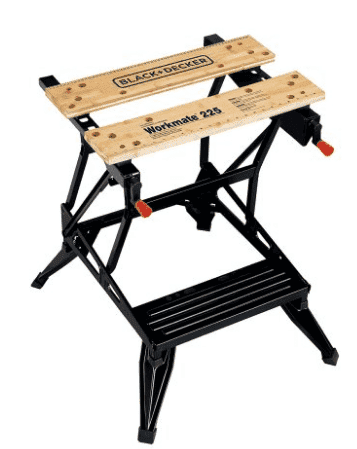

This is great for apartment dwellers. It'll fold up and hide behind a door.
The one pictured is a Black & Decker Workmate. I've had one since about 1980 when i lived briefly in an apartment . There are several other brands with similar products . Some are flimsy so comparison shop.
Thanks for that. Let me see if I can buy it soon.
Make sure that the rubber feet don't get lost. The naked ends of the legs can chew up your best living room carpet. The positive thing is that the coffee table no longer needs to be used as a sawing horse.
