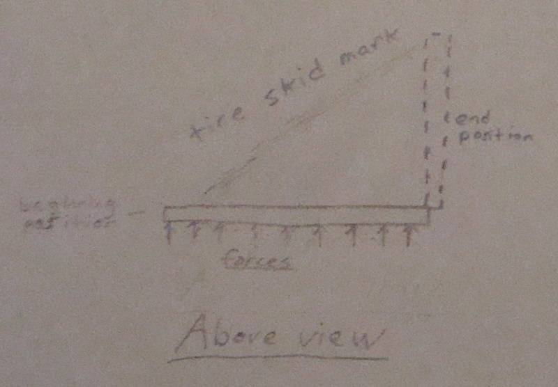

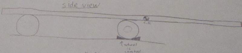

Yes, the ashphalt is horizontal. The beam is attached to the top of each tire, and the back tire is a fixed point. I'm trying to figure out how much wind it took to blow the front tire 90 degrees. I drew up a couple of diagrams, and will attach both. The first one is a side view and I will post the view from the top in just a minute.
Here is a view from above.
