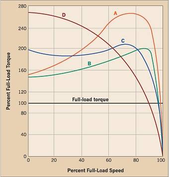

Not sure whether it's a right place to post. My question is from a field of electric drives.
I can't figure out how to choose an induction motor for a certain load.
Load is a simple cylindric flywheel fitted directly on a rotor. Flywheel has a known mass and dimensions. I know that a motor would accelerate until it's torque will be equal to the load torque. So to select an appropriate motor I need to know it's torque rating(torque at ). The question is how to calculate the load torque of a flywheel?

Below is an illustration. Several motor torque-speed characteristics are shown there. This cylindrical flywheel I described is a "constant torque" load i.e. torque doesn't depend on the speed rotation (black line in the picture).
The only thing I can't understand is how to calculate this load torque.

How is torque characterized as a function of slip frequency, that's what I want to know. I haven't delt with induction motors before. It's starting to bother me. I thought wikipedia would save me, but the article is kinda stoopid.
RomanU answered the matter of torque as a function of slip frequency pretty well with the plot in #3 above. There the abscissa is running speed, but if you take synchronous speed - running speed you have slip frequency.
As that plot shows, there are all sorts of different curves possible, depending on the motor design.

I see. Then you can tell me how torque varies as a function of slip frequency for a 3 phase motor.
The analytical expression for motor torque as a function of slip is fairly complicated and contains all sorts of design parameters that usually are not readily available unless you are the motor designer.
If you really would like to pursue this, I would recommend the rather excellent textbooks by P.C. Krause out of Purdue. I worked through his stuff a few years ago and did some motor simulations that worked out quite well. The problem, always, is to know the motor parameters. There are tests that can be performed on an existing motor to estimate the parameters, but this is only after the machine exists and is in your hands; this is usually long after you want the information. Krause gives some typical machine parameters, and I used those for some papers that I was writing, but they would not be valid for any particular piece of machinery.
