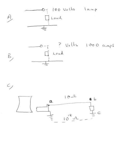

Earlier in the thread I invited you to do some calculations?
Anyway here are some sketches to help
In A we have a single supply connected to one end of a load, the other end of which is locally earthed. 1 amp is flowing to earth.
I have shown this supply as being 100 volts above earth, but what happens if the current increases to, say 1000 amps as at B?
How many volts above Earth is the supply now?
Further what happens if the voltage at Earth is not constant? How do we then define any voltage?
Now in case C we have a locally earthed power station supplying a load (earthed as before at c) by a supply line ab. This line is very long and has an impedance of 10 ohms.
The power station and the load are situated on a large granite formation so the impedance between the two is very high - I have shown 1018 ohms.
Now suppose 1, 10, 100 ,1000 amps flows down the supply what will the effect be on the voltage across bc and more importantly
If 1, 10 100 or 1000 amps enters the power station connection via an Earth 'return', what is the voltage across this vey high impedance? and how is it generated?
These examples are designed to show the absurdity of thinking of a 'return current' via earth.
A return current must needs equal the supply current.
The model, however, works well in terms of Earth being at a fixed potential, regardless of current sourced or sunk.

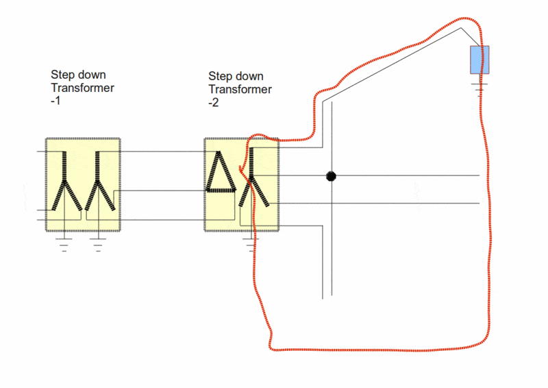

@Studiot: Earth can form return path for electrical currents, and you can not change it with false assumptions like 1018 ohms Earth resistance.
supply voltage V=100
Current = 1000A
Load resistance = 100/1000 = 0.1 ohm
that is again impractical. do you know the cross section of conductor required for 1000A current? such high loads are feed on higher voltages to avoid losses in cables.
what does that mean. voltage at Earth is taken as zero for reference.
earth resistance should be less than ~5 ohms. In normal wet soil it is easily achieved by simple ~3m pipe earthing. for rocky areas more surface area of earthing electrode is required or earthing can be done at some location away from load where lower Earth resistance can be achieved. In practical Power station / loads are not situated on large granite formation.
A simple distribution system with one load connected through Earth as return is given below, the Earth current is shown in red dotted line. the generator is not shown in the diagram as it will not carry any ground currents:
