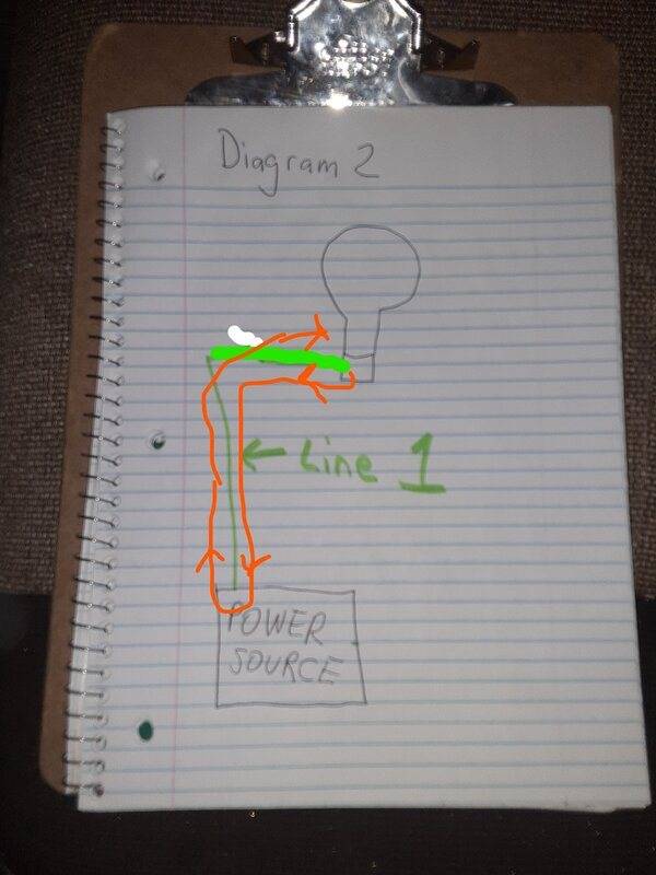

The reason for the creation of this thread is that I want to know why you cannot have the line 2 on the exact same wire as line 1. Below this sentence is Diagram 2:
The switch on diagram 2 is closed. The green wire on Diagram 2 is just ONE WIRE. The green wire on Diagram 2 only has one prong that plugs into an electrical outlet not two. The orange line on Diagram 2 is NOT A WIRE. The orange line on Diagram 2 is the current. The green wire on Diagram 2 is not one cord with two internal wires. The green wire on Diagram 2 is JUST ONE WIRE.
Anorlunda told me that in a circuit, current has to both leave the power source and enter the power source simultaneously. Phinds told me that current travels in a circuit like a bicycle chain, either it all moves or none of it moves. My diagram 2 follows both what anorlunda told me and what phinds told me about circuits. Why cannot the current flow in a circle (like a bicycle chain) both to the power source and away from the power source and to the load ON THE SAME WIRE as I depicted in diagram 2?
A standard electrical wire is a three-dimensional object, not two dimensional. I don't see why there is not room for current to flow in different directions on the same wire.

Such is the danger of "sorta like" analogies. The electrons are in fact not really like a chain (or a group of trunk- to-tail circus elephants)
There is no inducement for the electrons to travel down the wire and back...they will simply take the short route and bypass the wire completely. You do understand that the electrons are coming and going at the same instant? The power supply will see a short circuit and the lamp will see nothing at all...

Look at your figure. You have drawn one current upwards and one downwards, so they are going in the opposite direction. Since they are of the same magnitude and in the opposite direction, the net current is - zero.

That's the answer. What could you do to the single wire to make current circulate in that wire moving both directions at the same time? The answer is there is none.

Is what Svein what correct? I think that what Svein wrote is incorrect.
On an AC circuit with a line 1 and a line 2, the line 1 current is traveling in the opposite direction as the line 2 current, with line 1 traveling from the power source to the load and with line 2 traveling from the load back to the power source, yet the current will still light up the light bulb.

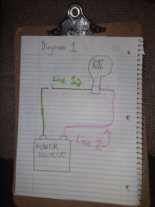

Let's pretend that the switch is closed in diagram 1. What induces the current in diagram 1 to travel in line 1 from the power source to the load and in line 2 from the load and back to the power source?

The power source provides the inducement. Usually in the form of a voltage. It is critical to note that the power source has two terminals, not one. In your post #1, you sketched a power source with only one terminal.

Would it be true to say that a circuit without a line 2 (like the circuit in the OP) would have no inducement because one line can only connect to one terminal (opposed to two terminals) on the power source?

The first thing that occurs in a “circuit” is that a voltage difference propagates from the source towards the load. A voltage difference requires two separate conductors, with an electric field between them.
How can a voltage difference travel in parallel up one wire, while that voltage difference is "short circuited" by that same wire?

It isn't a matter of "room". It's a matter of what potential difference the electrons are responding to.

You're getting close here, yes. Think about what I said above about potential difference. Your statement that one line can only connect to one terminal on the power source, whereas two lines can connect to two different ones, is correct. Can you see why that makes a difference as far as the potential difference the electrons will respond to is concerned?

EDIT/Update -- After a long set of PMs (and separate conversations between the OP and @PeterDonis and @Dale the OP is finally understanding the situation and is happy with the result. Thread can stay closed. Thank you everybody for pitching it to help the OP understand this.
