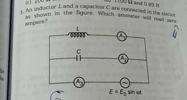

Circuit diagram: an AC source E = E0 sin ωt drives three parallel branches, with inductor L, capacitor C, and ammeters A1, A2 and A3 in series with each branch.
I don't understand why would the current be zero in any of the branches . May be I am missing something very fundamental .
Please help me understand this question .

The question should be 'which ammeter may/could read zero ampere?'.
There is a specific value of ω for which one of the meters would read zero.

Have you studied electrical resonance?

What will happen at resonant frequency in this circuit? What is the effective impedance of this circuit at resonance?

Resonance occurs at a particular frequency where Xc=XL. In this circuit, what would be the equivalent reactance at resonance?

Equivalent reactance should be 0 . The net impedance should be equal to the resistance but since there is no resistance R in this circuit , net impedance Z will also be 0 .

No, the reactances are in parallel here.

Should the equivalent reactance be infinite ?

Yes.

OK . In that case current in A3 will be zero at resonance ?

Yes.

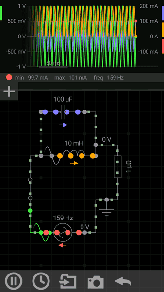

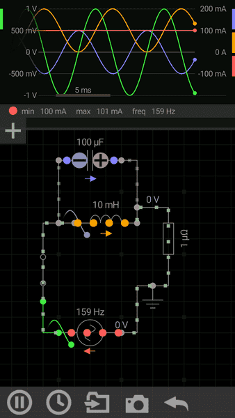

Here is a simulation result of the same situation. It agrees with the math in #23:smile:.
For the values of L and C used, 159Hz is the resonant frequency.
You can see the source current(red) is dc.

One more thing I forgot to add regarding one of your earlier posts:
To get A3 to read zero, you have to first connect the source to "put some energy into the LC network", then disconnect the source at a particular instant so that the energy will start oscillating between L and C, and then reconnect the source at a particular instant such that no current is drawn from the source.
Altering the frequency continuously till you hit resonance won't make A3 read zero, because whatever transient starts after you connect the source, lasts forever as there is no resistive damping. This is why I used the term "undamped transient" earlier somewhere. (Though if it lasts forever, it's no longer "transient", but I don't know what I should call it:-p).
