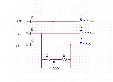

Find active power of the given three-phase system.
[itex]U_{RS}=U_{ST}=U_{TR}=220\sqrt 3 V[/itex]
[itex]R=\omega L=\frac{1}{\omega C}=10\Omega[/itex]
2. The attempt at a solution

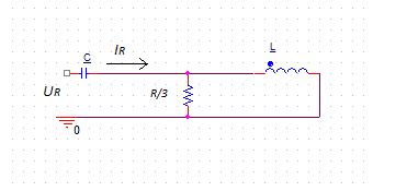

After reducing the circuit to one phase (see attachments), equivalent impedance is [itex]\underline{Z_e}=\sqrt{101}e^{-j84,3^{o}}[/itex].

Can you show your calculations for the equivalent impedance?
From circuit_2, [itex]\underline{Z_e}=X_C+(\frac{R}{3} || X_L)[/itex] where [itex]X_C=-j\frac{1}{\omega C},X_L=j\omega L[/itex].
[tex]\underline{Z_e}=3-j9[/tex]
I think this is the correct impedance.
Question: Expect calculations, are the equations for powers, impedance, voltage and current in my original post set correctly?

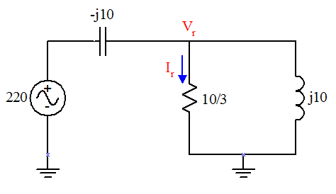

Your equivalent impedance looks right now.
How did you determine the potential across the resistor? In your equivalent circuit the capacitor is in series with the parallel combination of the resistor and inductor. Note that, since in a perfectly symmetric Y configuration the branches are essentially independent, you can ignore the phase angle of the source for a given branch if you're just looking for the real power in its load. Thus you have:
I put the magnitude of the voltage across the resistor at about 73 V, so whatever method you use to find it should find something similar.

You don't necessarily need the voltage across the resistor. But it's a simple way to get to the power dissipated since P = V2/R. You should end up with a power (for one branch) of about 732/(10/3), or about 1600 W.

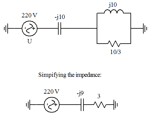

It must have something to do with the definitions of, or values of, your variables. Let's try a slightly different approach and see how it works out (It's a good idea to be able to check your work using different methods).
If the branch source voltage is U = 220 V and the branch impedance is Z = (3 - j9) Ω, then the branch current is:
##I = \frac{U}{Z} = \frac{220}{3 - j9} = \left(\frac{22}{3} + j22 \right)~A##
Then the complex power is p = VI* , so that:
##p = (220~V) \left(\frac{22}{3} - j22 \right) ~A = \left( \frac{4840}{3} - j4840 \right)~ VA ##
The active power is the real component of the complex power, so P1 = 4840/3 W.
What values are you using for UR and IR?edit: Fixed typo in power calculation (current value).

I have an idea of where your problem lies. I think you're applying a power formula for a Y-connected source with a Δ-connected load. That would explain the presence of the √3 before the voltage variable, converting the Y source voltage to a Δ line-to-line source.
In this case you've already combined the loads into a single Y-connected load, and the given line-to-line voltage to a Y-source of 220 V, so the formula won't apply. What you have is:
