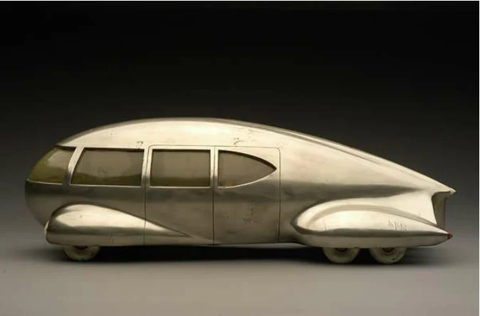

My thoughts were inspired by a passing utility vehicle on the highway. They had a device strapped to their truck that had its bulk toward the rear, like one might naively do if one wanted it to slice into the wind. I thought it should have its bulk toward the front like most highly-streamlined cars do:
Diagram showing two red airfoil profiles, one with a rounded leading edge and tapered trailing edge marked with a red cross, the other reversed and marked with a green tick, relative to apparent wind arrows.
Polished aluminium model of a streamlined car with a bullet-shaped body, rounded front, tapering tail and small wheels, shown in side profile.
But that got me wondering why it seems to be different for land vehicles than for aircraft. Aircraft (even subsonic craft) seem to go with the very pointy nose profile.

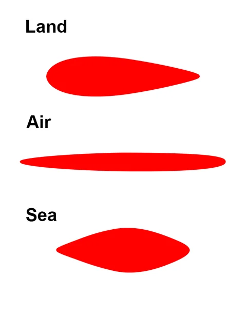

And that reminded me of an earlier discussion I was having with my brother about racing sailboats. Why are they so beamy? Wouldn't a narrower beam produce less drag? (Also, for the same weight, wouldn't a narrower boat also be longer, and therefore have a higher hull speed?)
So now I'm looking at the principles of fluid dynamics and wondering if - assuming a given size and function - is there an optimum shape, and does it differ based on the medium?
Three red streamlined profiles stacked vertically, labelled Land, Air and Sea: a bulbous, blunt-nosed shape for land, a very long thin shape for air, and a lens-like shape for sea.
I am wondering if the widest beam is related to balance. In an aircraft were nose-heavy it wouldn't be stable at differing air speeds (I think). Same with a sailboat (I think). A land vehicle doesn't ahve to sorry about this because its medium is solid, and it doesnlt have to balance.

Yes, supersonic craft have very pointy noses and leading surfaces (which I believe has a lot to do with controlling the shock front). What I was talking about is better illustrated in my diagram:
Three red filled outlines, each labelled above it: Land shows a teardrop shape widest toward the front and tapering to a point at the rear; Air shows a long, very slender cigar shape; Sea shows a shape with a rounded front and a pointed tail on a lenticular profile.
Jet aircraft - including subsonic jets - are not teardrop-shaped (with the widest point well forward of centre) - like a lot of highly-streamlined ground vehicles are.
(As for prop planes, I think the bulbous fore and tapering tail had a lot more to do with the giant engines they put in the front).
Virtually all jets - even those subsonic - have much more of a cigar shape.
If jets used the same principles of aerodynamics as ground vehicles, you'd expect them to look more like this:
Commercial jets have a cylindrical shape fuselage, between a parabolic nose and a conical or wedge shaped tail. The cylinder maximises volume while minimising sectional area and drag.
They do use the same principles, but ground based transport is slower and operates aerodynamically against the ground surface. The shape of a ground based vehicle should be seen from above in plan, or from the side, accompanied by its reflection in the road.
The weights and balances/mass properties part of this that @DaveC426913 suggested are really the best answer. The actual most efficient shape purely from an aerodynamics standpoint is the same in air or water. But the system-level trades are not the same because the system requirements are all very different.
Notice that, on an aircraft, the wings do have their center of mass more forward more like the teardrop shape. That's because they aren't driving the mass distribution as much and can afford to be more aerodynamically optimized. Aircraft also generally need to be large enough to carry people or cargo.
For boats, you have to consider buoyancy and making sure that the boat rides correctly in the water, not just that its drag is minimized.
