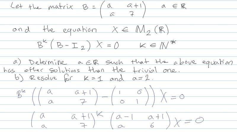

I have attached the relevant question as an image (for sake of ease)
Also attached, in blue.
Thanks a lot for any help at all!
  • Handwritten linear algebra problem: matrix B = [[a, a+1], [a, 7]] with a in R, equation B^k(B - I_2)X = 0 for X in M_2(R), k in N*; parts a) and b) with worked lines B^k([[a, a+1],[a, 7]] - [[1, 0],[0, 1]])X = 0 and [[a, a+1],[a, 7]]^k [[a-1, a+1],[a, 6]]X = 0.
You could consider ##B^k Y = 0##. Which property does B need to get non-trivial solutions for Y? How is that related to a?
##Y=(B-I_2)X##. How do you get Y=0 (which is a solution to the equation above) with non-trivial X? How is that related to a?
Perhaps the very beginning is where I'm having trouble, I don't know what times a matrix would be equal to zero. Is it the transpose? Or perhaps a matrix whose determinant is zero?
If you have studied matrices at all then you should know this basic property: the equation Ax= y has a unique solution if and only if A is invertible: [itex]x= A^{-1}y[/itex]. And that is only true if A has non-zero determinant.
The equation Ax= 0 always has the "trivial" solution, x= 0. It has other solutions if and only if its determinant is 0.
You're right, I should know that basic property :) I've been cramming too much this semester so I tend to forget.
Thanks a lot it makes good sense.
