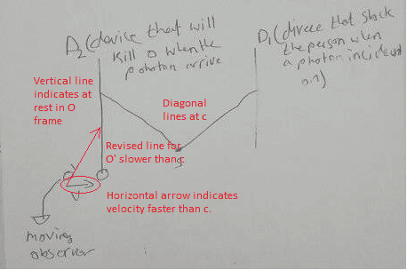

I was studying simultaneity and came up with this thought experiment:
Imagine there is a device that when a photon is incident on it it will give electrical shock that can lead to death .
Imagine one person standing on it and one approaching it from left at v and a photon approaching it from the right now relative to the standing person who is touching it the photon arrived and he died but relative to the moving observer since the speed of light is constant and the device is moving to the left the photon didn't arrive yet and hence the standing man is still. Alive . My question is what I had missed here?

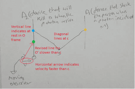

Then can the moving observer warn the one who is at rest or collide with him before the arrival of the photon relative to the moving frame?
Yes, it did. When two things (people, photons, whatever) move towards each other, their "closing rate", that is, the speed at which they approach each other, can exceed c even though neither sees the other as moving faster than c. Nothing is moving faster than c in any absolute sense.
Thus, to the moving observer, BOTH the platform AND the photon are moving towards him together and the photon arrives at the platform. To say it another way, the fact that the "moving" observer is moving relative to the platform has no effect on the platform or the photon.

Yes, if he is close enough that his signal gets there before the photon, although it's hard to figure how he could know that the photon is on the way since prior to its arrival to him (or to the subsequent signal from the platform after its arrival there) he has no way of knowing of its existence.

Anyhow I wanted to say that if the arrival is simultaneous in the rest frame but not in the moving frame there is an instant were the photon had arrived relative to the rest but not relative to the moving frame in one of the devices am I right? If yes then the standing person is dead in one frame and living in the other
The arrival is either simultaneous in both frames or not simultaneous in either frame.
If it is simultaneous then there is only one event. It is "simultaneous" in every frame.
If it is not simultaneous then there are two arrival events at the same material object. That means that the two events must be time-like separated. They will not be simultaneous in any frame. All frames will agree about the time ordering of the arrival events.
The only event pairs for which simultaneity is frame dependent are event pairs with a space-like separation. All event pairs on the world line of a material object are time-like separated. [Or not separated at all if we are pairing an event with itself]

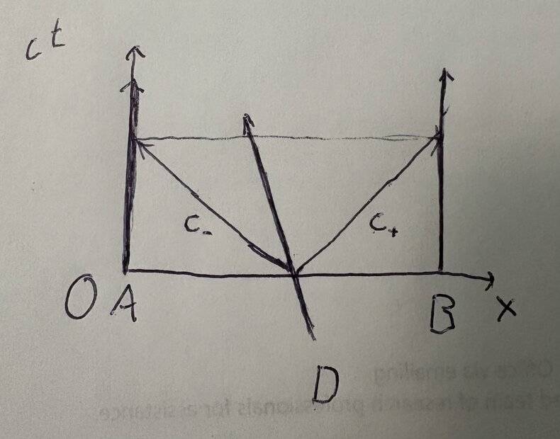

Okay if there is two devices and one observer at rest touching the one on the left and one is too close to him and moving towards him from left to right. he (that who is moving relative to the devices) knows that when he arrive at a specific position two photons at the middle between the devices will be emitted simultaneously relative to all frames because they occurred at the same point simultaneously then relative to the moving observer the photon towards the left device will take more time to reach the killing device than relative to the rest observer can he warn the rest observer or collide with hime after he is dead in the rest frame? Because he isn't dead yet relative to the moving person
Mathematics (in particular kinematics) was invented to avoid this sort of confusion of words. None of this is physics unless you can put some numbers in it and describe quantitatively what is going on.
So like this?
Where the observer O is at rest and colocated with detector A. Detector B is some distance away. A flash of light to the left C- and a flash of light to the right C+ are emitted when the moving guy D passes the emitter in between A and B. The flashes C- and C+ arrive at the detectors A and B at the same time in O’s frame.
Do I understand the scenario? If I have misunderstood, please clarify (preferably with a clearly labeled and described diagram). If I have understood, the how do we determine if D dies, what kills D?
