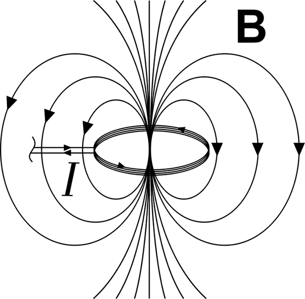

Ok, but while I'm trying to understand that, let me reiterate my problem:
Imagine a circular current loop, of a certain radius R, floating in the vacuum of space, and lying perfectly still. We'll only use classical considerations. To keep things simple, we'll ignore electrical resistance and heating and other real world considerations of this sort.
The loop is of zero thickness. There is a current in the loop which is increasing at a constant rate, through its own volition without the application of any electric field.
Such a magical current can still generate a magnetic field.
We specify that ##\frac{dI}{dt}=k##, a constant. The changing magnetic field is described by the vector field ##\frac{∂B}{∂t}##. In this scenario, it is easy to see that ##\frac{∂B}{∂t}## will always be a scalar multiple of B. The magnitude of ##\frac{∂B}{∂t}## is directly proportional to k.
Although unrealistic, there are no EM waves of any sort. ##\frac{∂B}{∂t}## is entirely static, as is the E field generated by the changing B field.
Is this specific enough?

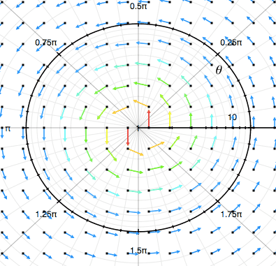

I have an idea. Since we have a circular current loop, let's assume that the E field has rotational symmetry about the axis of the loop.
The axis of the loop is also the direction of the z-axis.
Let's assume that the E field has no z component, it has only x and y components. This field circulates around the axis. So the field lines are concentric circles.
Next, we construct circular line integrals, which are perpendicular to the axis and centered on the axis. Using the integral form of Faraday's law, we can easily find the voltage. Then, in order to find the magnitude of the E-field that encompasses the line integral, we can just divide the voltage by the radius of the circle.
It's quite hard to calculate. But I wonder if such an E-field will satisfy the Maxwell-Faraday curl equation.
We can imagine three components of the E field. One circulates the axis. The second radiates outward from the axis. The third lies parallel to the axis.The circulating and radiating fields have no z components. The parallel field has no x nor y components.[/color]

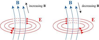

There is rotational symmetry about the loop's axis for the B-field. We assume that this extends to the E-field as well.
We assume that the E-field circulates the axis:
The 3rd image is not so accurate to the problem I described, but its the best I could find.
