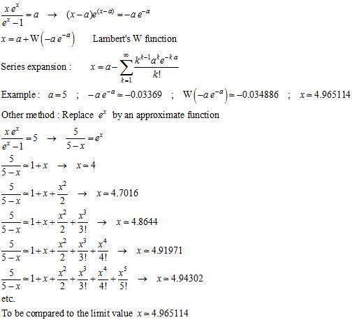

Hi !
the method proposed by assed is not stupid at all if we consider the problem on the practical viewpoint (i.e. approximate numerical method, but not exact analytical method)
But, as shown in attachment, it will require a very large limited expansion of the function to be accurate enough : That is the drawback.

First off I get x~4.965114231744276303698759131322893944056 so 4<x<5
The exact solution can be expressed using the Lambert W function
x = W(-5/e^5)+5
you can use http://www.wolframalpha.com/input/?i=x+e^x/(e^x-1)=5
As far as the proposed method I would describe the problem differently
we desire to solve
f(x)=0
it is totally valid to write f as a power series and solve it for x
the question is how to do so as in general I do not think much is gained
As was mentioned above if you truncate the series the zeros move.
You would need to read an approximation book about methods that preserve zeroes
usual fixed point methods (like Newton's method and its variations) are probably a better approach
