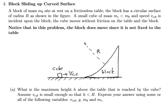

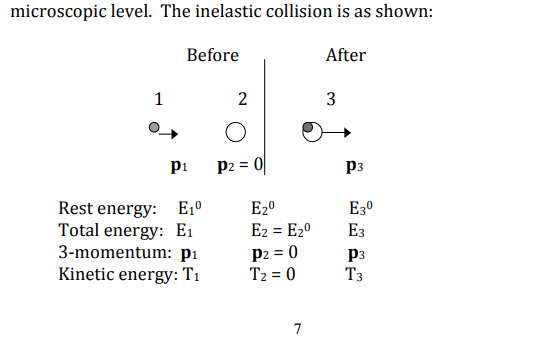

When writing this article I was quite taken with the idea of an inelastic (collide and coalesce) collision in which there were no dissipative energy losses. I had come across this concept in one of the problems I dealt with in a previous article - it comes from an MIT problem set on collisions:
Because the small block reaches a point where the two masses are at rest with respect to each other, the conditions for an inelastic collision are momentarily met. So part a) of the problem can easily be solved by setting the standard expression for energy "loss" in an inelastic collision equal to the PE gained with the point being that in this case the collision energy is not lost - it is simply converted to PE.
Similarly in the problem dealt with in this article we again have an "inelastic" collision in so far as all the particles are at rest after the collision. But once again the collision energy is not lost - it simply ends up in the mass of the kaons. What would be fascinating is if one could somehow have an energy storage system in which those kaons (instead of decaying) are maintained as "mass" until the stored energy is needed. What more "compact" means of storing energy can there be than as mass ?!
