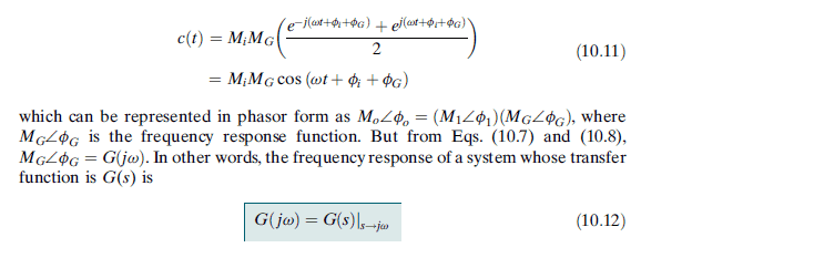

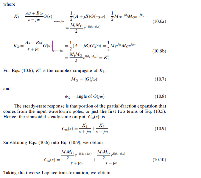

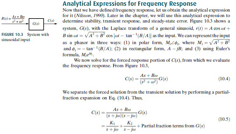

Hi,
I am struggling to understand the maths in the text shown below.
(1) How does: r(t) = Acos(wt)+Bsin(wt)
become; sqrt((A^2)+(B^2))cos(wt - arctan(B/A))?
(2) He states that we can represent the input as a phasor and in one of three ways but doesn't say which one.
(3) He then focus on the forced response {R(s)} the laplace transform of the input.
(4) He then then separates the forced solution from the transient solution by performing a partial faction expansion but I am unsure what is meant by this separation?
Any help genuinely appreciated.
Block diagram of a system with input R(s) = (As + Bω)/(s² + ω²) entering a box labelled G(s), output C(s), with the surrounding text on analytical expressions for frequency response.
Equations 10.6a to 10.10 from a textbook: K1 and K2 defined with G(jω) and its complex conjugate, MG and phase φG, leading to steady-state output Css(s) as a sum of two partial fractions.
Equations 10.11 and 10.12 from a textbook: c(t) = MiMG cos(ωt + φi + φG) with its exponential form, and G(jω) = G(s) at s = jω.
1) First write r(t) in rectangular phasor form:
r(t)=Acos(wt)+Bsin(wt)
=Re{A exp(jwt)}-Re{jB exp(jwt)}
=Re{(A-jB) exp(jwt)}
=Re{sqrt(A^2+B^2) exp(-jarctan(B/A)) exp(jwt)}
=sqrt(A^2+B^2)cos(wt-arctan(B/A) //
2) You can see from 1) that I started in trignometric, went to rectangular then used Euler's formula and a property of exponentials to simplify. This can also be done with trig identities but there are extra steps and since you have a linear system this is an easier approach anyways.
3) I believe the author has implicitly assumed a linear time invariant system, G(s), which is stable and hence the transient contribution is negligible in the long term therefore he focuses on the sinusoidal steady-state response only, C_ss(s).
4) partial faction expansion is a method to isolate the "poles" of a rational function. Remeber the location of the poles are growth (or decay) rates of the exponential functions in the time-domain. Incidentally in this example the poles s=+-jw are associated with the output (and input) frequency since sinusoids are the eigenfunctions of LTI systems.
