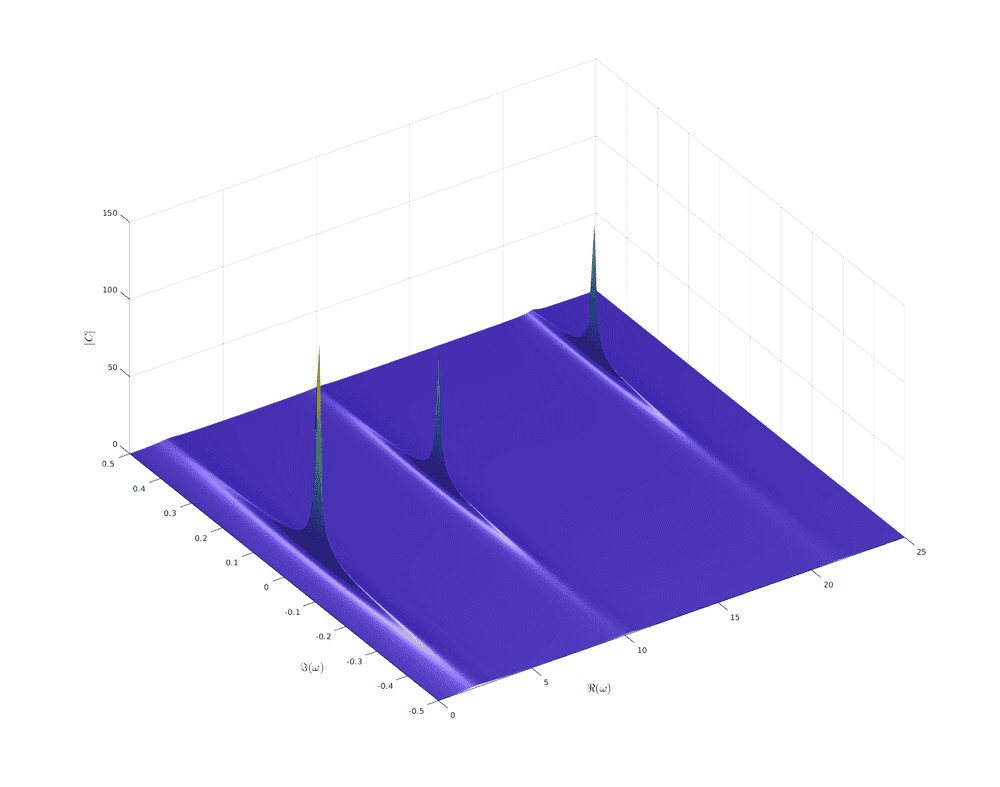

Hi PF!
Here's an ODE (for now let's not worry about the solutions, as A LOT of preceding work went into reducing the PDEs and BCs to this BVP):
$$\lambda^2\phi-0.1 i\lambda\phi''-\phi'''=0$$ which admits analytic eigenvalues
$$\lambda =-2.47433 + 0.17337 I, 2.47433 + 0.17337 I, -10.5087 + 1.16033 I, 10.5087 + 1.16033 I, -22.0562 + 3.13425 I, 22.0562 + 3.13425 I...$$
There's an analytic technique to solve which is not terribly difficult (again, you'd need the entire system of equations to do this). However, another way to solve this ODE is to change the nature of the problem from an eigenvalue problem to a frequency response problem, where now the eigenvalues ##\lambda## are instead input parameters of the forcing frequency:
$$ \lambda^2\phi-0.1 i\lambda\phi''-\phi'''=f \lambda$$
By carefully selecting basis functions ##\phi_j = \sin(\pi(j-1/2)x)\cosh( \sqrt{ (\pi(j-1/2))^2 + 1} )## we can take inner products of this equation, resulting in a square matrix linear system of algebraic equations:
$$\lambda^2 M-0.1 i \lambda V - K = F : M_{ij} = \int_0^1 \int_0^1 \phi_i(x) \phi_j(y)\,dy\,dx,\\
V_{ij} = \int_0^1 \int_0^1 \phi_i''(x) \phi_j(y)\,dy\,dx,\\
K_{ij} = \int_0^1 \int_0^1 \phi_i'''(x) \phi_j(y)\,dy\,dx,\\
F_{ij} = f\int_0^1 \phi_i(x) \,dx.$$
The vector solution for each ##\lambda## input is denoted ##C##. If we plot the magnitude of ##C## against several values of ##\lambda## we would arrive at a frequency response (see attached picture). The ##\lambda## values associated with the peaks are in fact the eigenvalues of the unforced problem.
Okay, now for my question: the ##\lambda## associated with each peak is real. However, I know the analytic solution (written above in decimal form) is complex. How would I separate the forced solutions of ##\lambda## to ascertain the real and imaginary components of the analytic eigenvalues?

Neat. If there are reasons to assume the peaks are first order poles located just off the real axis, then you could peak fit the curves given,
##f(\lambda) = \left|\sum \frac{A_k}{\lambda-p_k}\right|^2##
extracting the magnitude of the imaginary pole offset, ##\text{Im}(p_k)##. The sign of the imaginary components would likely have to come from some principle like causality in the case of particle physics for example.

I guess, not knowing anything about the problem beyond what you've written, that you are looking at what's called a resolvent, ##R(\lambda)##. The resolvent for an operator, ##A##, form this would look like,
## R(\lambda) = \|(A-\lambda I)^{-1}\|##
which becomes singular at an eigenvalue of ##A##. In your case this is at a complex locations I've blessed with the label, ##p_k##.

##A## is the operator which leads to the eigenvalue problem you posted. The driven problem, much like the resolvent, will have resonances located in the complex ##\lambda## plane. Your plot is a cut taken along the real axis.

When you generate the complex vector ##C##, why must you use real ##\lambda##? Any complex value should work, well except at exactly an eigenvalue that is.
Okay, so you're suggesting taking a 3D image instead of the 2D slice? Interesting idea!
Also, attached is the problem broken down into better wording, for you viewing convenience (though I think you already understand what I'm talking about).

Thanks! Okay, so turns out your suggestion in post 9 did the trick! Thanks so much! I've included a plot, and you can clearly see the poles lie off the real axis. When I compare these results they match the analytic prediction! Just wanted to post to close the matter. Thanks a ton Paul!
